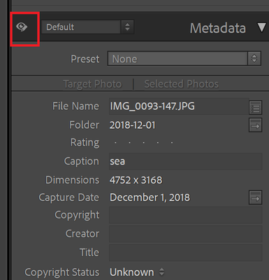

Do you see the following icon (highlighted in red) in the Metadata panel? Wanted to confirm that you are in the Edit & View mode, not in the Edit mode.
When you say, the Metadata not getting update, what exactly happens? You type something in the Caption field and press Enter, it vanishes? Or, you move to another photo and come back, the Caption field becomes empty?
Sunil

Yes, Sunil, I am in Edit & View mode. When this problem occurs, and I type in the Caption field and press Enter, the caption shows up in the Caption field but not in the photo thumbnail. (I'm using Expanded Cells as my Grid View Style.)
