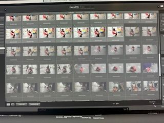

Hello;
This has never happened before.
Today i was out on a shoot.  When i tried to import the images on my SD card, only a portion of them downloaded.  The missing images can be seen on the monitor, but they are not downloading and there is no way to check them.
Any help you can give will be greatly appreciated.
I'm using an Apple M1 max with Sonoma 14.4.1
Thanks in advance.

Are the missing images grayed out?  Can you post a screen shot?
Community Beginner ,
Apr 12, 2024 Apr 12, 2024
Good question.  Yes, the missing images are grayed out.  I've tried checking and unchecking but that doesn't work.
Here's a screen shot.

Your screen shot cut off the parts I wanted to see!
I'm on Windows but have seen something similar.  One of my cameras starts a fresh naming sequence after I format the card.   After several shoots I can have several different images with the same file name.   If I check the box for not importing any duplicates, images will be grayed out like your screen shot.  Images are different but file names are duplicates.

 In addition to posting my isssue on this site, I also posted it on Fred Miranda and someone responded that grayed out images could mean that the images had previously been imported.  That triggered my memory that, indeed, I had imported the SD a bit earlier and then, for some reason had decided to delete that import and start again.  Well, I screwed up and deleted only some of the images, and that created the problem.
Thanks to all who helped.
Apr 13, 2024 Apr 13, 2024
So the answer is that the greyed out images were already in Lightroom, having been imported earlier and not deleted later.
