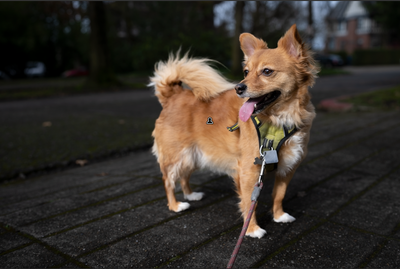

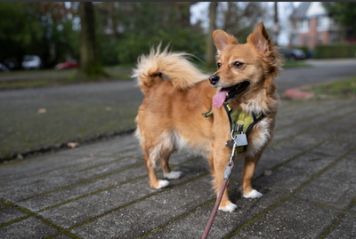

I used this 8640 x 5760 .arw (11.4 times as many pixels as a smart preview):
I edited with the smart preview of the photo, made an inverted Subject mask, and set Exposure = -1.5:
Then I restored the original .arw (using the mask edits created for the smart preview) and exported it as a TIFF.  I repeated the same process with the original .arw, exporting a second TIFF.   That is, one TIFF was exported from the original using the smart-preview mask, and the other TIFF exported using the full-resolution mask.

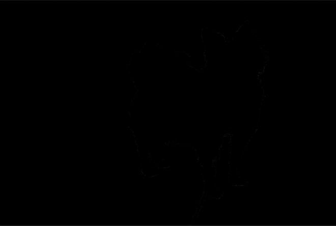

Visually, the two TIFFs look identical. I opened them as layers in Photoshop and blended the layers with Difference. The flattened result looks all black, meaning there's little visual difference between the two:
I used Levels to exaggerate the differences:
As expected, they're around the fringes of the dog's fur, most of which are luminance differences of 4/255 or less.
