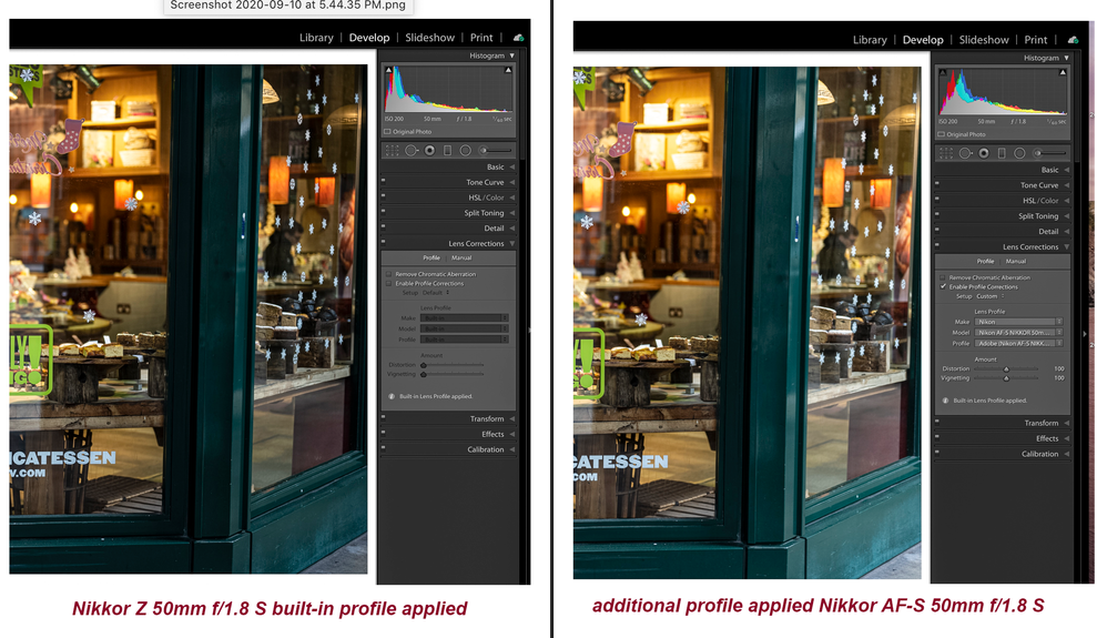

Sep 10, 2020 Sep 10, 2020
Ok I have done a test with some Nikon Z6 files with the Nikor Z 50mm f/1.8S this is what I get with one of the files. The builtin lens profile is applied and if I select Enable lens profile corrections it just indicates builtin profile. If I select custom the Nikor AF-S 50mm f/1.8 S profile gets selected. There is no Nikor Z 50mm lens profile in the list of Adobe Profiles available for Nikon.
See the screen capture. The is a difference in the lighting but little or no distortion correction for either lens.
It certainly looks that two profiles are applied. See the screen capture.
Screenshot 2020-09-10 at 5.57.57 PM.pngScreenshot 2020-09-10 at 5.45.39 PM.png
