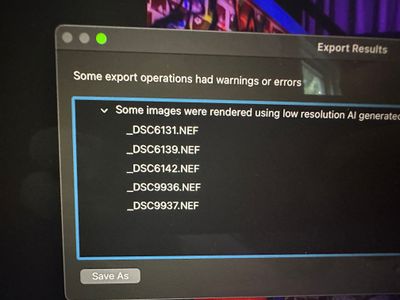

 Your change to AI Denoising has decimated my workflow. It often takes two-three passes of updating AI Denoise settings...and even then, when I export my photos I still have no idea if they'll export with the most up-to-date settings! It takes me roughly three times as long to output photos now. I'm really unhappy with this.
New Here ,
Aug 13, 2025 Aug 13, 2025
This discussion forum is on Lightroom Classic (LrC), but the screenshot shared should be from Lightroom Desktop ( LrD ).
Anyways, please do try out the latest update of LrD and check whether the issue is still seen.
