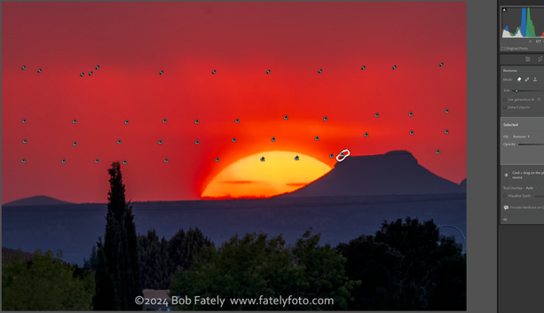

Well, the generative removal tool does not seem to work on power lines. Photo of a setting sun (so lots of orange); power lines with no background other than the orange sky) - attempts to select the power lines themselves proved fruitless. After a few seconds of "thinking" the power lines were not altered in any way.
Running on a MacBook M3 Pro - 18GB RAM, Sonoma 14.5.1

@f8lee: "After a few seconds of "thinking" the power lines were not altered in any way."
Working with the low-resolution export you attached, I can easily remove the power lines one by one:
 Since that export stripped all the clueful metadata, I can't give precise remedies, but things to check:
- Make sure the Opacity slider is 100.
- When you select a line, make sure you select the entire line -- if you leave any bits unselected, Remove will generate a matching replacement.
- Detect Objects often doesn't work very well with lines -- uncheck it.
- If you had previously applied Crop, Transform, or Lens Corrections, undo those, apply Remove, and then redo them. Remove will match the unselected cropped-out pixels on the edges otherwise.
But if this doesn't help, please attach a full-resolution JPEG exported from the unmodified original photo, including all metadata.
When removing objects against a uniform sky, Remove sometimes doesn't do a good job of blending in the replacement. I got better-blended replacements by making the edges of the selected ragged and selecting the lower three lines in one selection:
johnrellis
October 21, 2024
[This post contains formatting and embedded images that don't appear in email. View the post in your Web browser.]
@f8lee, also, the older Content-Aware Remove does a fine job removing the lines, doing one short segment at a time. To do Content-Aware Remove, select Mode: Remove and uncheck Use Generative AI.

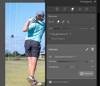

I was excited to try the update using the removal tool with Generative AI in LRC . I had a telephone pole against a blue sky that needed to be removed. Unfortunately, LRC did not get the job done. Sometimes it deleted a piece of the pole, sometimes it gave me a crooked wobbly pole, but never did it entirely remove the pole. I am most disappointed.

Remove easily removed the pole and its shadow from your screenshot:
Your screenshot shows that you've cropped and applied masking. In general, you should Remove first, then crop and use AI masking. See this article for more details:
https://www.lightroomqueen.com/generative-remove-replace/
Most complaints about Remove are addressed in the article. But if it doesn't help, please attach a full-resolution JPEG exported from the unmodified original photo, so we and Adobe can see the issue in detail. With nearly everyone who has posted a problem photo, we've been able to show how to quickly remove the desired objects.
