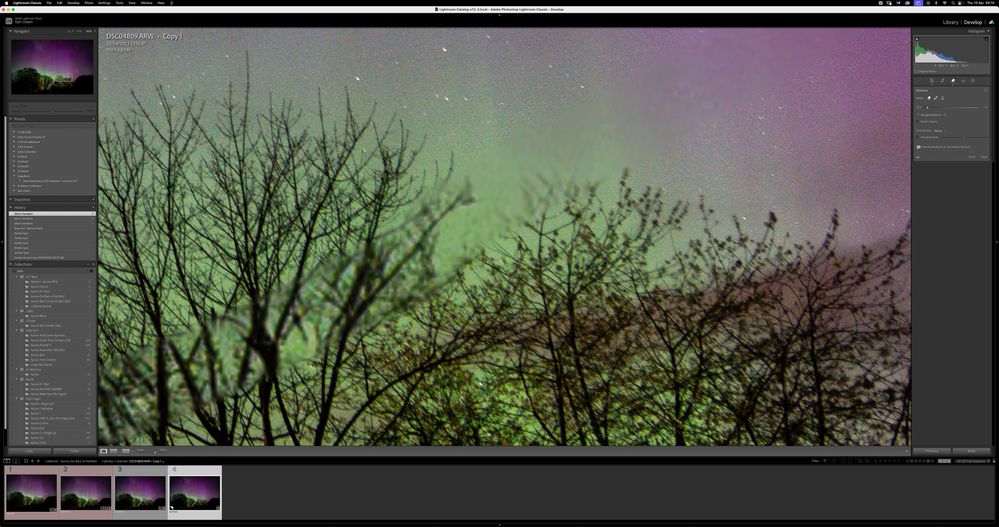

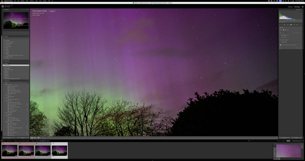

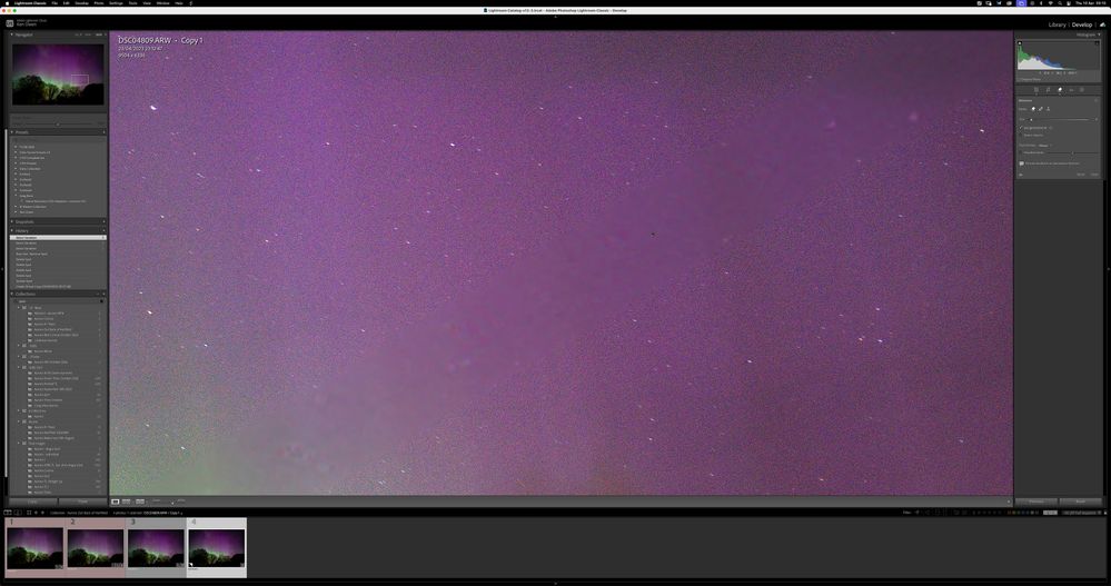

New Here ,
Apr 09, 2025 Apr 09, 2025
looks terrible even after cycling through options. Will never recreate noise or stars. better no to waste time on it
New Here ,
View the full size images to see the smudgy crap that the ai generative remove creates when removing the telephone wire behind my house.

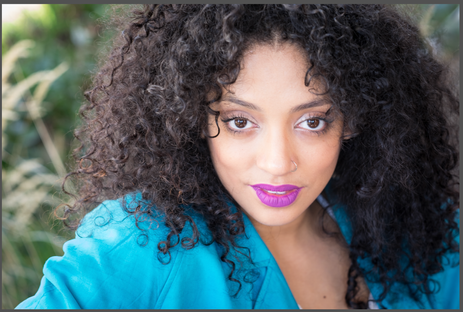

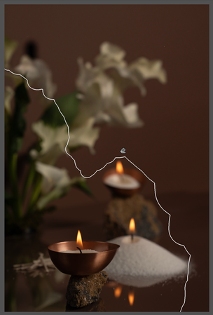

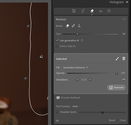

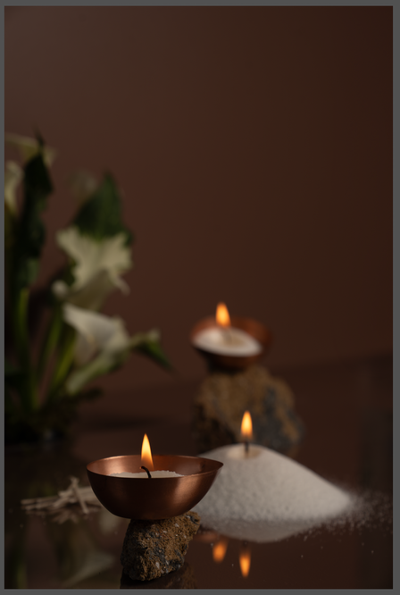

The AI remove tool used to give me seamless extended backdrops but lately there is a clear indication of where the brush starts and ends - if you look at the top right corner of this image where the backdrop ends and where I attempted to use the tool to extend it, you can clearly see the brush stroke and the line where the generated backdrop starts. This is a serious flaw and it was NOT always like this! But in the last few weeks it has been happening to my images almost every time I attempt to do this. Would love to see this fixed so that it performs how it was months ago. Thank you for your time! This tool has seriously changed my work for the better, but now I'm used to this as a quick fix.
Advocate ,
Apr 12, 2025 Apr 12, 2025
@RM Photography the model was not changed.
The issues you see now always existed.
@johnrellis has detailed several methods to improve the chances of success when using Genrative Remove.
Check his posts in this thread.

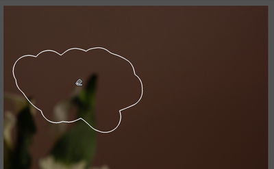

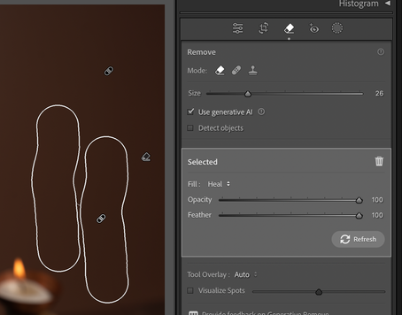

LEGEND ,
[This post contains formatting and embedded images that don't appear in email. View the post in your Web browser.]
@RM Photography: "The AI remove tool used to give me seamless extended backdrops but lately there is a clear indication of where the brush starts and ends ... it was NOT always like this! But in the last few weeks it has been happening to my images almost every time I attempt to do this."
Generative Remove has always had problems matching uniform gradients -- there are many posts about that in this thread going back to last October and in the previous beta thread last summer. You've just been unlucky recently in tripping over it.
I've included below a full list of techniques that often (but not always) ameliorate the problem.  Here are two ways that worked using your sample raw:
1. Apply Denoise to remove the noise. Then Remove. Then use Heal tool with shorter strokes and feathering = 100 to blend the replacement boundary:
Remove:
Heal:
Result:
2. Select the entire background including a little bit of the plants along the edge of the background:
The Remove boundary isn't visible, but because I selected the edges of the plants, Remove generated a larger bunch of flowers.  A second Remove can replace them with more background:
Final result:
Many have observed here that the replacements made by Generative Remove sometimes don't match the photo's tone or noise. To get better matches, these techniques sometimes help:
1. Adobe recommends applying Denoise before Remove. This can reduce the noise, making it more likely the replacement will match.
2. The replacement patch supplied by Adobe Firefly has a maximum size of 2048 x 2048 pixels. If the selected area in the photo is larger than that, then the replacement patch gets upscaled (and blurry). Try removing smaller selections if possible.
3. Conversely, try making a larger selection, even including the entire background. Upscaling of the replacement sometimes won't be noticeable then.
4. Sometimes there's a distinctly visible boundary where the tone or noise don't match. You can often use the heal tool around the boundary to get better feathering and make it less noticeable -- apply Heal in small brush strokes. Or use a Brush mask with maximum feathering, dropping local Texture, Clarity, and Sharpness to their minimum values. Sometimes, making a very raggedy selection around the object makes the boundary less noticeable.
5. For grain/noise in particular, see this post for how to ameliorate the problem by adding the grain back or reducing the grain:
https://community.adobe.com/t5/lightroom-classic-discussions/p-generative-remove-feedback-lr-classic...

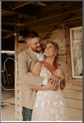

New Here ,
Apr 15, 2025 Apr 15, 2025
My generative AI seems to be adding items (random buttons, baby doll heads) NOTHING to do with the image. This is supposed to remove items, correct? This is a simple removal of someone in the background. Do betterrrrr
LEGEND ,
@Carlie26372870bwcy: "My generative AI seems to be adding items (random buttons, baby doll heads) NOTHING to do with the image."
Remove does a good job  with your screenshot:
To use Remove more effectively:
1. Uncheck Detect Objects before brushing a selection -- it doesn't work well, especially with skinny objects and along the edges of photos.
2. See this short article for how to remove objects more reliably:
https://www.lightroomqueen.com/generative-remove-replace/
3. Most complaints about Remove are addressed in the article. But if it doesn't help, please attach a full-resolution JPEG exported from the unmodified original photo (not a screenshot). With nearly every one of the many dozen problem photos posted here, we've been able to show how to quickly remove the desired objects.
