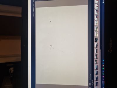

New Here ,
Jun 22, 2022 Jun 22, 2022
Copy link to clipboard
Copied
I imported as usual. I can see the previews of the images. I haven't adjusted anything and this is what I see. Please help!
Votes
LEGEND ,
Copied
1. Do you have the option in preferences to use graphics processor on? If so, does the problem go away if off?
2. Does a update exist fir your GPU driver?
Votes
