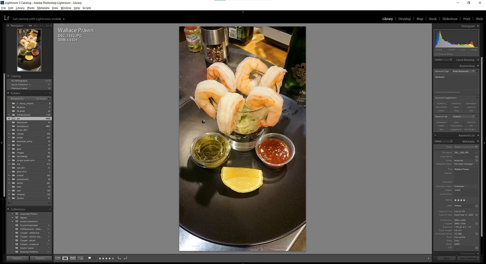

A screen capture of your copy of Lightroom, in the Library Module. The full screen, would help clarify what exact app you are using.
Problem is caused by Adobe Marketing that confuses application name, Photoshop Lightroom, Lightroom CC, Lightroom, Lightroom Ecosystem (Cloud Based), Lightroom Classic.
Also, in Lightroom, click on Help, then System Info, copy and paste first five or so lines in a reply.

February 16, 2023
Here ya go - thanks.  Why the OS version is incorrect, I have no idea.  As you can tell, this is a very old version of LR, orginally installed by the company I bought my workstation/licenses from.  I've not attempted to upgrade it, because it works fine for my purposes, and my use is occasional.  If I were a professional photo guy, I'm sure I'd be on whatever the latest release is.
Lightroom version: 5.7.1 [994254]
License type: Perpetual
Operating system: Windows 8.1 Business Edition
Version: 6.3 [9600]
Application architecture: x64
System architecture: x64
February 16, 2023
Oh - should have mentioned:  Lightroom Classic 5.7.1.  Windows 10.  (Where's the Edit button?)
