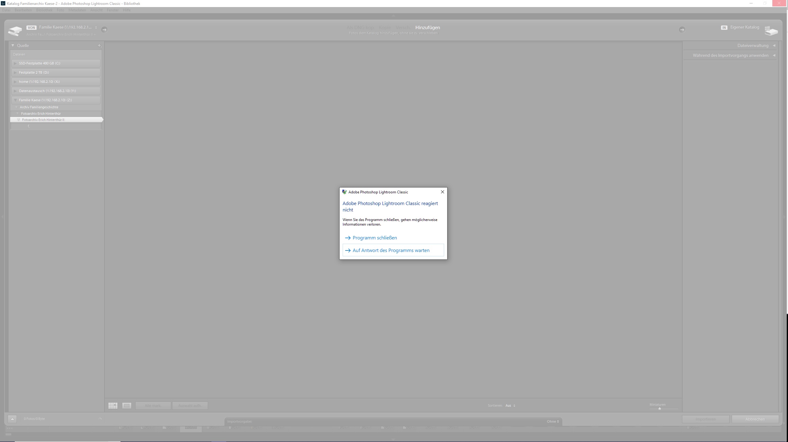

I have the same problem. Lightroom Classic CC (Version 8.0) crashes when I want to import photos (add folder). All drivers are updated, Windows 10 and Creative Cloud are updated, my computer has no other problems. It is not overheating. The CPUs reach about 30 %. only about half of the memory (16 GB) is used. I did delete the cache already, I deleted and re-installed Lightroom, etc. No additional Lightroom modules are installed.
I don’t know what to do, the expensive subscription becomes unusable to me. I have to process a certain batch of photos within my workflow and can’t.
Any help?

Nov 25, 2018 Nov 25, 2018
It appears you are trying to add images from a NAS into your catalog. There are several types of NAS that lead to problems such as crashes or lockups in Lightroom. I have no clue why that happens but several people have reported that here.

Thank you all kindly for your help. It’s correct that the folder I’m trying to import is on my NAS. On the same Lightroom catalogue, I have about 15 000 photos in maybe 50 folders on the same NAS. It’s unclear to me why this specific one keeps crashing repeatedly.
However, I have now tried a workaround, which seems to have solved the problem: I copied the folder to a local hard disk, then imported it into Lightroom. After deleting the folder on the local disk, I pointed Lightroom to the “new” location on the NAS. This worked!
Not ideal, but at least I continue with my work.
