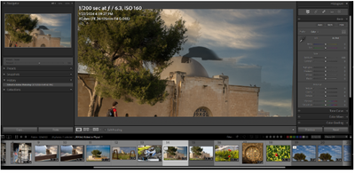

After almost 2 months absence from this thread of problems I've been experiencing in LR Classic, I want to return to the issue.
I have changed the configuration of my computer. I have doubled the system memory from 32g to 64g. I have changed the "Camera Raw Cache Settings to 100g and placed it on a SSD drive. And I have added a GPU (MSI GeForce RTX 3060 VENTUS 2X OC Graphics) with 12g of memory.
Overall performace of the machine seems to be better but I'm not running benchmarks here.
The problem of LR Classic correctly displaying an edited photo seems to still exist.
The following happened after exporting a photo to PS, changing the sky and saving.
Notice that the image appears correctly in the Filmstrip but not on the main screen or in the Navigator Window:
Sychronizing the folder does not fix the problem. Shutting LR down and restarting does fix the issue.
Suggestions please.

Notice I moved exposure to +4.47 but change is only reflected in the film strip below.

Here's what happens when I do a simple crop:
Close the crop "tool" and the action is reflected in the filmstrip but the photo in the Develope panal is not cropped. I will close LR and restart and the photo will be cropped as wanted.
