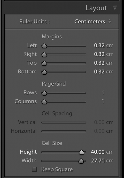

"Latest Version" doesn't help us.  Look at "About Lightroom" and report the exact version number.  For all practical purposes A0 through A6 are all the same aspect ratio; however there are some slight round-off errors in the paper cutting process.  I entered both ratios, 42 x 59.4 and 40 x 57.4 and both were accepted.
I am not sure how you are creating the 1cm border.  I would do it in the Print Layout settings.  Due to slight variations in paper size and feed tolerances of the printer, borders do not always end up perfect.
My screen shot is for A3 paper with a 1 cm border; my printer is not large enough for A2.

My method is usually-
1. Choose paper size in Setup
2. Set Image Settings for "Zoom to Fill"
3. Set Cell Size sliders to 'maximums'
4. Define all four Margins to required size- eg. Set size to 1cm
This avoids the problem stated by JoeKostoss​ when an Image RATIO (eg. 3:2) does not exactly match the paper ratio with fixed borders. With 'Zoom to Fill' you may only lose a very small part of the image if the crop ratio is the same as the paper ratio.

Yesterday evening I once again have tried experimenting a bit with the Print Settings. "Zoom to Fill" was the answer to this problem. Now it works really fine.
I have always tried kinda workaround - I have cropped the pictures to the DIN format (minus the size of the border) right from the beginning in the Lightroom Development Tool.
