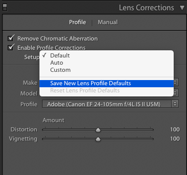

I've recently bought the Tamron 150-600mm G2 lens for my Nikon. Now, the problem arises when I want to apply lens correction (distortion correction/lens profiles). Every. Single. Image, the lens has to be manually selected in the menue. "Automatic" Lens Profile recognition does not work for Tamron; it does, however, work for Nikon lenses.

Correct answer Ian Lyons
The drop-down menu adjacent to 'Setup' in the Lens Corrections [anel includes an option to save the current choice of lens the default when LrC detects its use in an image.

This is indeed impressively helpful! Thank you much!
It does automatically apply this now to my Tamron lens and does not overwrite my Nikon lens.
