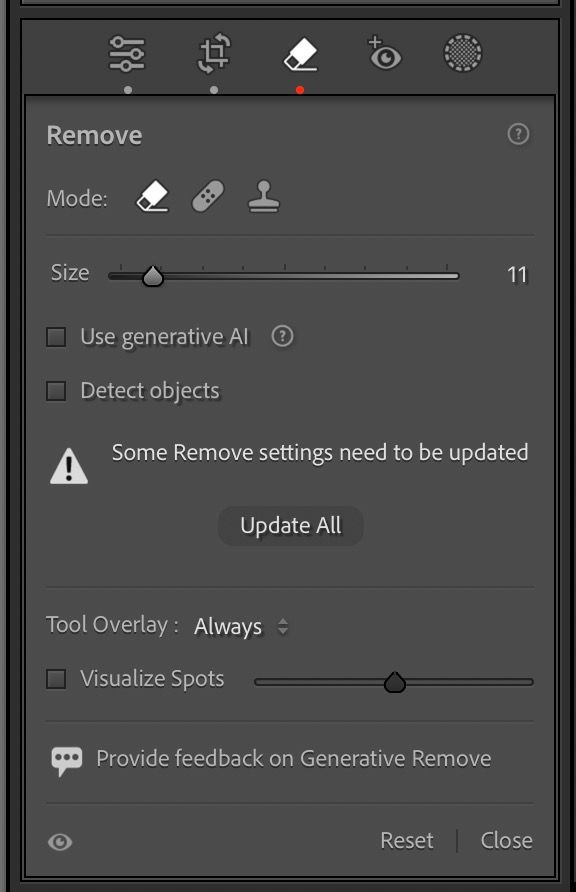

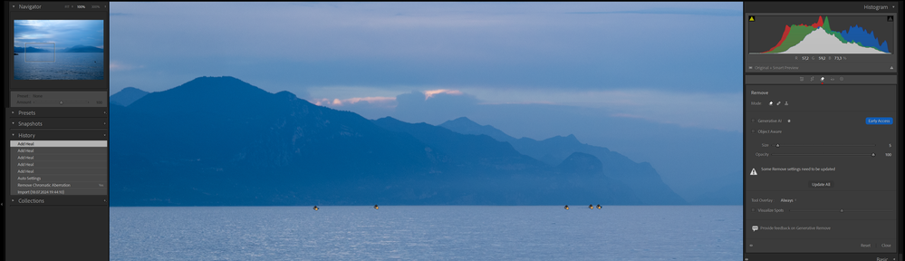

Hello!
I have the following problem in Lightroom Classic (13.4), that is blocking my workflow. Maybe someone could help me out with this one.
Whenever I use the remove tool in the develop module, soon after there is the warning "Some Remove Settings need to be updated" and the changes that where done are gone. This happens espacially when I go on to a different photo and return to the previous one shortly after. All (new) changes that I had done before with the remove tool are affected. Other edits/changes are not affected.
This also happens sometimes while I use the remove tool in the same moment, in this case only the most recent instance is affected. But the other ones that have been done before that, will be affected afterwards after going to a different photo and then returning to this one.
Using "Update all" is only working for a few moments, the problem keeps on returning.
All remove tool instances that where done before the issue occurs for the first time are not affected. Only new changes that are done with the remove tool are affected. This is equaly for using Generative AI and also when not using Generative AI.
I updated Lightroom to Version 13.4 on 6th of July and could edit my photos without any issues on that day and the following day. One week later I wanted to continue my editing, that´s when this issue occurs. There was no further update of Lightroom Classic in between.
I have checked and tested the following things, that I found before while searching the community discussions, but none of it works:
  • GPU is updated with the current driver
    • The problem occurs on my desktop PC and on my Microsoft Surface PC
  • Turned OFF the use of the GPU
  • Deleted the helper.lrdata file
  • Reset the Lightroom preferences
  • Imported and tested with a new photo
  • The most recent History entry is selected and there is no other new entry
My specs:
  • Lightroom Classic 13.4
  • Windows 11 Pro (all Windows updates done)
Best regards
Jan

LEGEND , Jul 26, 2024 Jul 26, 2024
These symptoms can occur when LR can't write the .lrcat-data file for some reason, either because LR has corrupted it or there is a permissions issue.  LR stores computed masks in that file.  Try these steps:
1. In LR, do Edit > Catalog Settings > General > Show. That will open Windows File Explorer on the current catalog folder.
2. Exit LR.
3. Move the file <catalog>.lrcat-data to the Desktop.
4. Start LR.
5. In Library, select all photos and do Photo > Develop Settings > Update AI Settings.

LEGEND ,
2. Exit LR.
4. Start LR.
5. In Library, select all photos and do Photo > Develop Settings > Update AI Settings. That will recompute all the AI masks, which could take a while. But it won't update Generative Removes, so you'll have to go to each photo with Remove, click on Remove, and then Update.
New Here ,
Jul 28, 2024 Jul 28, 2024
Hello John!
Thank you very much for your solution. It seems that this fixed my problem. The error message has not returned yet and new edits are possible.
As you have mentioned I had to update all Generative Removes manually for each photo. Fortunately this was doable because it only affected about 25 photos. So I am very thankful that I can continue my edits.
Do you know if this could happen more often and is there something I could do to prevent this from happening again? If there are way more photos edited with Generativ Removes in the future, such an issue could be very painful.
Thanks again!
