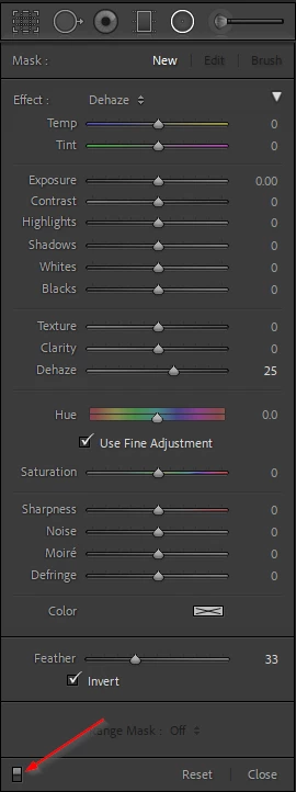

Hey all, I am realatively new to LR, at least as far as heavy editing goes.  I am adding radial filters but I can't seem to figure out how I can turn a radial filter on and off so I can see the adjustement I made.  I also use Nik Silver Efex and when I add control points (basically a radial filter) I can at any point turn just one (or multiple) control points off.  For me at least, this really helps me see if I'm moving in the direction I'm trying to go.  The only option I see in LR is to turn off ALL the radial filters.
Any help would be greatly appreciated.
Correct answer dj_paige
This button/slider will turn on or off Radial Filters (and any adjustment tool or panel has this button).
If you want to select specific radial filters to turn on or off, you'd have to select the filter, delete it, then use Ctrl-Z to undelete it and Ctrl-Y to delete it again, in sequence, so you can see the effect of just that filter.
January 2, 2021
Thanks dj_paige, that's how I've been doing it I was hoping Adobe had a better option.  Thanks again, I can now stop searching the google machine 🙂
