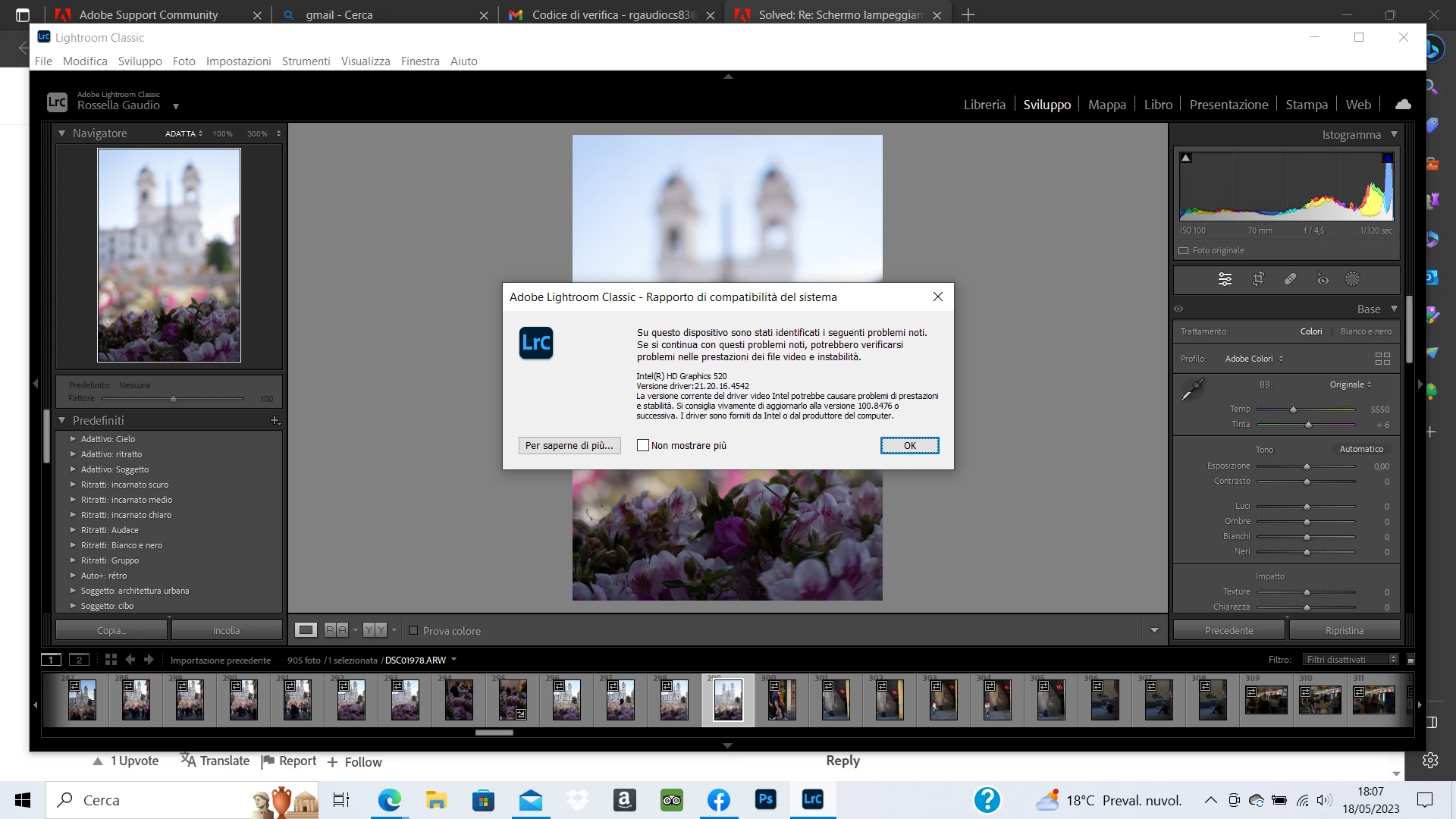

Quel problema l'ho risolto. Ora ne ho uno con lightroom....mando screenshot

    @Rossella29898566nnfp
    Moved to Lightroom Classic. Please type out the error message so we can translate it.
    Jane
    May 18, 2023
    Ho provato ad aggiornare ma non mi fa installare questi driver....non so proprio che fare
    johnrellis
    May 20, 2023
    Google translation: "Adobe Lightroom Classic - System Compatibility Report
    The following known issues have been identified on this device. If you continue with these known issues, you may experience video file performance issues and instability.
    Intel(R) HD Graphics 520
    Driver Version: 21.20. 16.4542
    The current version of the Intel video driver may cause performance and stability issues. It is highly recommended to update it to version 100.8476 or later. Drivers are provided by Intel or the computer manufacturer."
