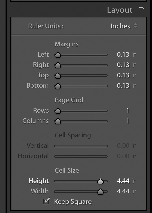

One suggestion:
Import the up-sized image back into Lightroom
Set a square crop in the Develop Module
With that square, crop a small detailed section of the print
In the Library Module, check the size of the cropped image in pixels.
If the size is more than 800 pixels per side crop again to a smaller section until you get an image less than 800 pixels
Divide the pixel dimension by 180 to get a print size at 180 ppi.  Example 800/180 = 4.44 inches
Print that cropped image on a 5x7 or larger sheet of paper from the print module with the following changes:
     In the "Image Settings" panel uncheck "Zoom to Fill"
     In the "Layout" panel, check "Keep Square" and type in the result from your calculation above (Example 4.44).
Print that image on a 5x7 sheet or larger.  This will give you a visual of how the whole print will look.
Hint:  Don't pixel peep, that is view this 5x7 from a distance that the viewer would normally see the full print, which would be about 3 x the diagonal, or about 10 feet for a 24 x36 print.
