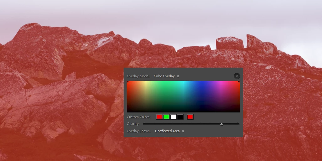

I was expecting this AI based feature to be able to select a sky accurately, with little need for refinement.
However, having tried it on dozens of images with a clearly defined horizon line, I find that it consistently selects a certain amount of area below the horizon as well. It seems that this unwanted selection goes about the same distance from the horizon in every image, and it follows the horizon line. Which makes me think that it knows where the horizon line is, and still selects below it.
At 100% view, the overlay shows clearly that part of the landscape is selected.
This is also confirmed by editing the selection.
Setting the color overlay to show the unaffected area tells a different story, it indicates (wrongly) that the landscape is unselected, as well as lower parts of the sky.
This makes Select Sky only marginally better than a regular graduated filter.
Both require work with a brush set to Subtract.

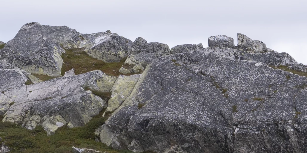

Below is the unedited image for reference.

On your examples, that Granite will be sneaking into the mask as it has blue, and the lighting is what it is, So, I assume a quick remove mask is Color Range.. Or you could try an intersect using color range, picking blue, just not the blue in the Granite.

The mask overlap into non-sky areas was probably done to minimize demarcation fringing. This can be seen in image files when the shooting lens has visible chromatic abberation (see below bug report). By softening the mask edge these types of mask artifacts are minmized. What might be helpful is to provide a Refine mask control similar to what's availble with the Color Range control.
By @Todd Shaner
Yes, a Refine mask control would be perfect, where you could control the width of the mask edge, as well as other things.
In the example I posted, the mask covers about 250 pixels of the landscape.

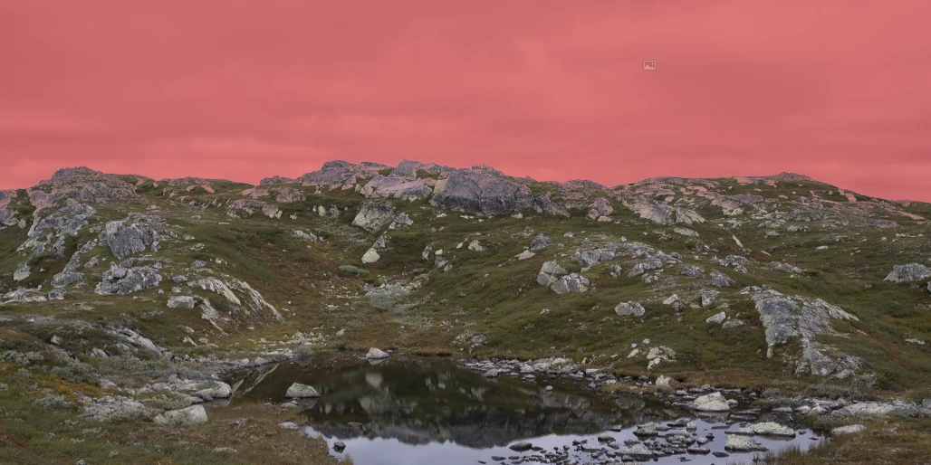

JohanElzenga
Oct 30, 2021 1:24 PM UTC
While I agree that the routines could be improved, I would suggest that you judge a mask by what the adjustment looks like, not by what the mask overlay shows you. The reason is that a little overlap into the landscape below the sky is not necessarily a bad thing. It avoids ugly halos around the edges, for example. It could also make an image look more natural. If you adjust the sky in your image and make it more blue, but leave the top of the rocks completely neutral, then the result may look less natural than if the top of the rock has a very slight blue tint as well. That's because the light on top of the rocks is reflected from the sky and so it actually would be a bit blue if the sky was blue.
I have found that the majority of my sky masks do not need any fine tuning if I look at what the adjustments do. But if I just look at the mask overlay, I would conclude that it definitely needs to be fine tuned.
-- Johan W. Elzenga
JohanElzenga
Oct 30, 2021 1:36 PM UTC
To illustrate my point:
-- Johan W. Elzenga
