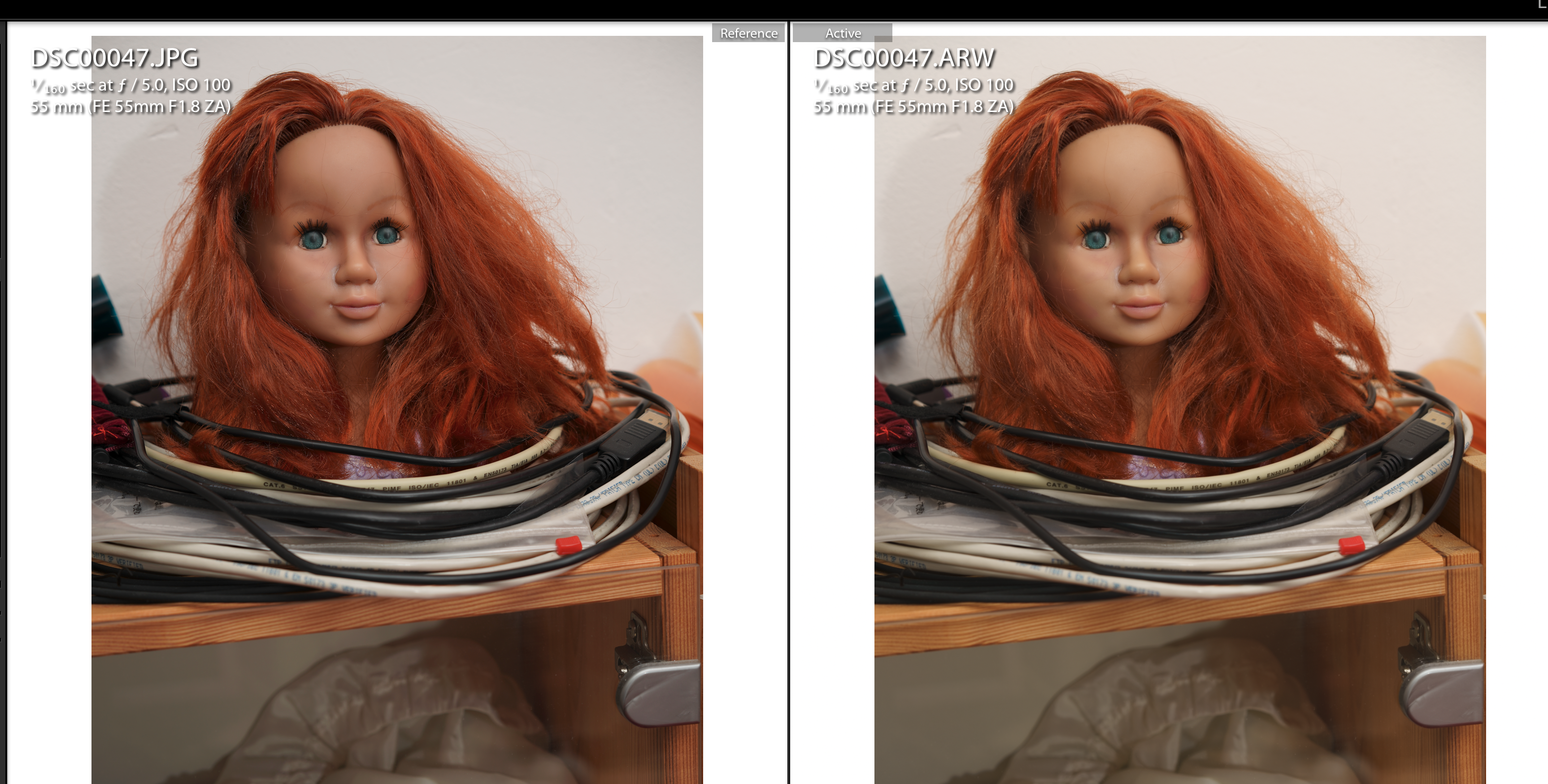

I use Lightroom Classic 7.2 Camera Raw 10.2, as far as I know I have switched all special settings to off in the A7r III.
Here is the RAW file and also OOC Jpeg:
Dropbox - DSC00047.ARW
Mar 22, 2018 Mar 22, 2018
I can also see the difference between the OOC jpeg and the LR raw on screen display. Interesting just one thought was the Camera set to record the jpeg with sRGB or Adobe RGB color space profile. See the screen capture from my Lightroom Display of the comparison.
I guess there is no way to check the settings that were used in camera.
