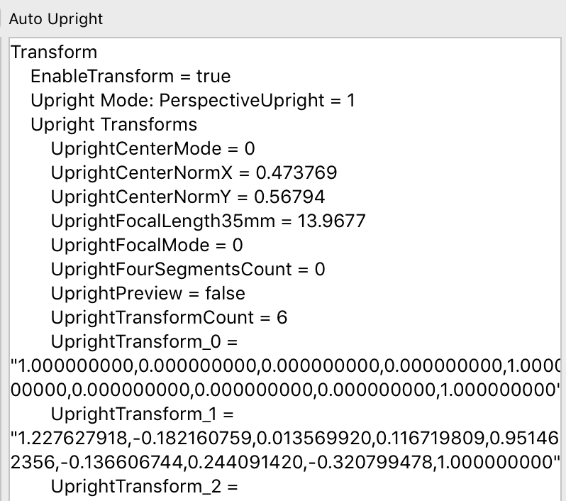

It depends on how you define the preset. If you select just Upright Mode:
then the preset will contain just the choice of Off, Auto, Guided, Level, Vertical, and Full. The contents of the preset will look like:
When you apply the preset, it will recalculate the actual upright transformations.
But if also select Upright Transforms when you define the preset, then the calculated transformations for the current photo will also be included in the preset:
When you apply this preset, those transformations (calculated from the original photo) will be applied to the current photo, and the "Update" button will be displayed in the Transform panel to let you recalculate them based on the current image if you want.
At first I found this confusing, but it makes logical sense. The manual describes the behavior, though it's a little out-of-date: Upright automatic perspective correction in Lightroom

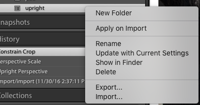

So in the final analysis, what is the efficient way to get each picture to upright transform
based on each picture's own configuration. I did copy/paste, easy enough. I dont see how
to apply the preset I made tho. Further, upon inspecting the contextual menu, which I never
used before, what about this:
What does "new folder" create? A folder of images with the preset applied?
"apply on import": isn't it a little too late to try to apply on import since all
the images ARE imported at this point?
"Update with current settings" actually does not update the selection(s) with
the current preset settings, it updates the settings belonging to "import" preset.
"show in finder" - How do we show upright in finder??
"export" what? Export the preset? This seems an odd place for the over all
export feature. Same with "import". If I import from here, does that mean this
particular preset is added to the import?
OK apply preset in Library module makes this all work.
My suggestion is, make a preset where you've checked Upright mode, but un-checked any specific transforms.
That forces Lightroom to work out for each image, what transforms that individual image needs.
Or you can Sync or Copy-Paste - making sure that you are only transferring the upright mode and NOT specific transforms.
If you have AutoSync active, and click on this preset in the list to apply it to the main image, then it will also be applied to the other images.
No, you can organise your presets into subfolders if you want.
"apply on import": isn't it a little too late to try to apply on import since all the images ARE imported at this point?
You can set your Import procedure to include the application of a Develop preset (and a Metadata preset) if you want. But that will only affect future imports. It's just for convenience, if you know that all those images will need this preset to be applied by default. I don't think that can be said, for Upright since there is wide variation as to which mode, if any, suits the photo.
Say you'd made a preset which applied certain settings. Then you applied the preset to a given picture and thought 'on reconsideration, it would be better if this preset applied different settings'. You'd change the picture to those different settings, then use this option to update the content of the preset - to redefine what the preset DOES.
this means, show the PRESET in finder - it's a structured text file. You might want to copy it into another computer so that it could be used there.
"export" what? Export the preset? This seems an odd place for the over allexport feature. Same with "import". If I import from here, does that mean this
This whole menu is all about managing your presets, and has nothing to do with managing your pictures.
regards, RP
