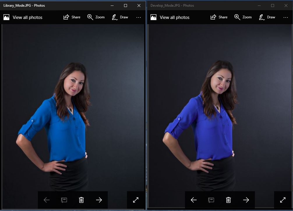

I am constantly seeing a color shift....... But this color shift in the BLUE is unbeliveable... What is causing this...
If I spend time editing a photo to reach a perfect color and then export it and It Turns Color on me.... What good is LIGHTRoom?
Windows 10 Monitor is Color Calibrated with i1Display Pro
Library Module on the LEFT and Develop Module on the right.
If you're seeing the color shift within LR between the Develop and Library modules, that usually indicates your display is assigned a color profile that's incompatible with LR. See this article for how to quickly troubleshoot and then correct the issue: http://www.lightroomqueen.com/articles-page/how-do-i-change-my-monitor-profile-to-check-whether-its-corrupted/

If you're seeing the color shift within LR between the Develop and Library modules, that usually indicates your display is assigned a color profile that's incompatible with LR. See this article for how to quickly troubleshoot and then correct the issue: http://www.lightroomqueen.com/articles-page/how-do-i-change-my-monitor-profile-to-check-whether-its-...

Large differences in color between Develop and Library is almost always the result of an incompatible, defective, or corrupt display profile. It's very easy to diagnose, in just a couple minutes -- just assign the sRGB profile to the display, as described in the article. If there is no longer any difference, then the problem is very definitely the profile.

Why are these screenshots from Windows "Photos" - which as we all know is not color managed at all?
But yes, a difference between Library and Develop is a defective display profile. No display profiles are "incompatible" as such, but if they don't follow icc spec, Lightroom will choke. So depending on which calibration software was used, LUT/table-based and/or Version 4 profiles tend to be problematic. Either because they're more complex to begin with, or because the specification isn't well established.
If they are correctly written, Lightroom has no problems with any particular profile types.

To respond to the Photos viewer ... I sort of tricked the process to get both images on a single file. I displayed the image in the Develop Mode and captured a screen shot. Then I displayed the image in the Library mode and captured a second screen shot. then I opened up both images in Photos, placed them side by side and captured a third screen shot, which is what I attached to my original post. YES ... there could be some color shifts in all of the "screen captures" but the whole point was to show there was a significant shift in color, which my convoluted process represented.
Back to your comments.... I understand what you are saying. And I think your reference is similar to what others have said... that there may be a Profile issue.... You mentioned Version 4 .... so has someone else... you also referenced a complex profile or one that is not well established. The "well established" issue triggers a thought... (and you don't have to respond to this.... but regarding my conversations with X-Rite, could they have an opinion that their settings are "more established than they think?)

First, there IS a difference in how LR produces previews in Develop versus all other modules. The visual differences should be rather small and you MUST view both at 100% (1:1) to correctly preview the data.
Next, you state: If I spend time editing a photo to reach a perfect color and then export it and It Turns Color on me
If you see a difference between Develop at 100% (the most accurate way to be previewing the image) and another application outside LR after export, then that application isn’t color managed! Do check the display profile as suggested, do not let the software calibrating and producing an ICC profile to build what is called a V4 (Version 4) ICC Profile (check that applications settings/preferences).
I notice you referenced "AFTER" export and not "In the Library Mode" .... it's interesting that you state that, because later into the evening, I noticed that there are actually THREE colors not just two ..... 1) Develop Mode in Lightroom 2) Library Mode in Lightroom and 3) in Windows Photos 'after' exporting. All three are different. If I remember correctly, the Library mode represented the most significant difference of the three.
Just forget Windows Photo; not color managed. That it doesn’t match what you see in LR is to be expected.
