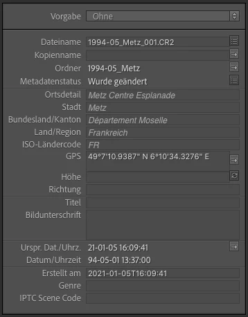

- Open Canon RAW image (.CR2)
- LR reads GPS data from XMP file

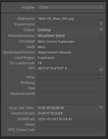

- GPS data and location are correctly shown in LR CC, i.e. location: 49°7'10.9387" N 6°10'34.3276" E
- Export to JPEG
- GPS data is shown incorrectly in JPEG EXIF, looks like a rounding error, i.e. 49°0'0" N 6°0'0" E (verified through EXIF Tool and also re-import of the JPEG into LR.

The .xmp file contains coordinates that don't conform to the XMP standard:
<exif:GPSLatitude>49.11970520N</exif:GPSLatitude>
<exif:GPSLongitude>6.17620210E</exif:GPSLongitude>
Rather, the standard calls for DDD,MM.mmk format:
<exif:GPSLatitude>49,7.1823116667N</exif:GPSLatitude>
<exif:GPSLongitude>6,10.5721266667E</exif:GPSLongitude>
I don't know why one part of LR (import) accepts the non-standard format, while another (export) chokes on it.
What program or device produced the .xmp?  You should file a bug report with them.  You could file a feature request with Adobe asking them to accept this format, but I think it's very unlikely they'd do it (that's the point of standards, after all).
