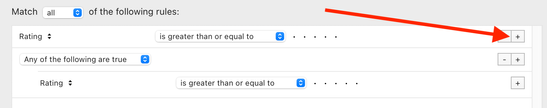

"implement Boolean logic statements"
Smart collections do offer full boolean logic:
Match All: AND
Match Any: OR
Match None: NOT
You can get subexpressions by holding down Alt / Opt when you click the + button:
