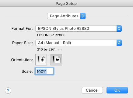

    Hi sjj58 - don't give up just yet... try this... I was able to select fine art papers after doing this:
    Tap Page Settings in Bottom Left corner go to Paper Size and select either US Letter or US 11x17 > then Manual Roll > close this dialog box and then go into print settings. You should be able to select Fine Art Papers now.

    Was the printer ever working in the past from LR, and now it has stopped? Or, is this a new printer and the first time you're trying it from Lightroom? After printing, does it show up in the print queue for the Epson printer? Is it possible it's going to the wrong printer?
    Have you checked the settings under "Printer Setup" - the button at the bottom of the left-hand panel in the Print Module? Can you show us a screen shot of this dialog open?

    sjj158Author
    Mar 19, 2018 4:32 PM UTC
    Hi Mike
    Thanks for taking the time to answer. I have had the printer for about 6 years now and it used to be fine with LR, it's a more recent thing.  When it is sent to print then yes it shows up in the Epson print queue so definitely going to the right printer.  Here are screenshots
    of the print dialogue boxes, maybe there is something obvious I am doing wrong!
