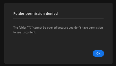

I am just now getting around to using LR with the new MacOS install, assuming that is what is causing the issue? However, I have followed guides on line to supposedly allow it to work, however it is still erroring out. Below is the error, and below that is the access I gave to LR and still does not correct the problem.
Not sure what else to do at the moment ... Not seeing anything else online, unless I missed it about this.

Is there any solution? I have the same problem.
Sep 28, 2024 Sep 28, 2024
Denied folder permissions are a MacOS thing, not something Lightroom does. You try to access a folder that Lightroom does not have the right to access. Contrary to popular belief, 'Full Disk Access' does not mean Lightroom has access to every folder on your disk. There are still folders, such as most system folders, Time Machine disk folders, and folders belonging to another user account, that will not be accessible. Without detailed information about the folder you try to access with Lightroom, nobody can tell you how to fix it (or if you should not try to fix it but choose another folder).
