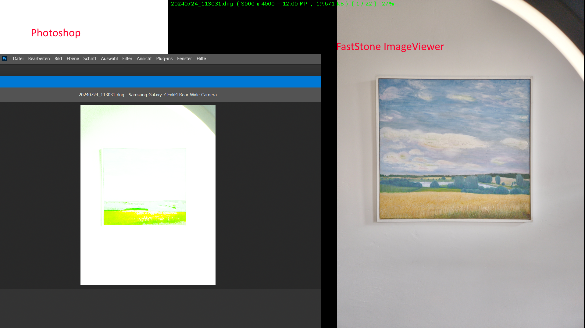

New Here ,
Aug 08, 2024 Aug 08, 2024
Just for the sake of completion: I am able to recover those files with faststone image viewer. It loads them and shows them "in a good looking way", I can also adust brightness curves and then export to jpg etcetc.
New Here ,
here is one example, it worked flawless a few months ago, only difference in exif in file header is samsung version (cannot attach file, so uploaded here
https://drive.google.com/drive/folders/1qWFtMNJlIuYo8IWi8hTMEHAEBjqDVXwo?usp=sharing)
LEGEND ,
@Arvid Terzibaschian: "I am able to recover those files with faststone image viewer. It loads them and shows them "in a good looking way", "
Faststone is displaying the embedded JPEG preview, which is not corrupted. Another way of accessing the embedded JPEG preview is by using Exiftool, as described above:
https://community.adobe.com/t5/lightroom-ecosystem-cloud-based-discussions/lightroom-mobile-samsung-...
