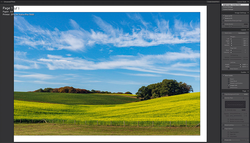

Perhaps the problem is this. Some printers need a bit of extra paper margin to hold it. For my Epson Stylus Pro 7600 I created a preset that looks like this, so no margin at the left side. When I print using this layout, the final print has a perfect edge on all sides.
-- Johan W. Elzenga

Oct 21, 2018 Oct 21, 2018
not sure how I did it or where to find the preset if i needed it again BUT creating a preset solved my problem.
can't thank you enough Johan.
Good to hear! If you saved the layout as a new preset, then it should be in the left panel, at the top. If not, then save it as a preset there by clicking on the plus icon.
