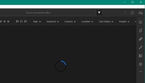

Disclaimer: I don't expect to be a "Lightroom CC" convert, but I thought I'd have a look for kicks. So I installed it on my work Mac, which sits behind a corporate proxy. I have no problems running any of the Adobe applications behind the proxy - they all play nicely with the proxy servers.
But in Lightroom CC, I have a message in the top right corner telling me "Network Disconnected". Nothing happens. Failed at step 1. I can't see any settings relating to proxy behaviour and I can only guess that "network disconnected" means that Lightroom CC can't find its way out through the proxy.
Is this for real? Lightroom CC is 100% "cloud-native", but can't work with a corporate proxy? Tell me I'm doing something wrong...

I have the same issue. Adobe Creative Cloud application works perfect, but Lightroom CC gives an error "Network Disconnected". It also shows a crossmark with the Cloud Icon.
We use port 8080 for the proxy server and block port 80 because otherwise people can bypass the proxy server.

I have also been battling this issue. What I have found is that when the proxy is manually entered in OS settings the Lightroom CC works fine. When the proxy is set to auto configure or to use a configuration file, the application shows as offline.
I have performed traces with Wireshark and I can see that when the proxy is set to auto, most connections do go through the proxy but the application tries to contact servers within Amazon's cloud directly on port 443. This of course fails because of the firewall. So it seems that the application does not support automatic proxy configuration.

This is still an issue. We reproduce this issue in our enterprise proxy enviroment. We see with wireshark that lightroom bypass proxy and want to go to amazon direct. To bad for our lightroom end-users that cannot use this application.
Adobe - it has beens years, when will this be fixed? Or can you explain why this wont be fixed.
