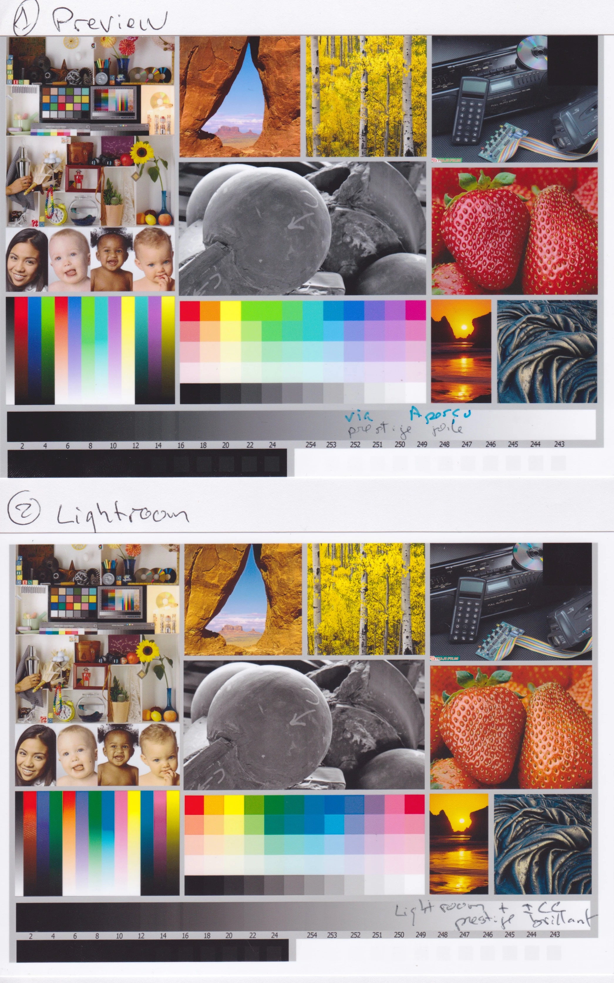

But when importing the same image to Lightroom, and printing it, using the same ICC profile, results are totally different. In Lightroom, the display on the screen is comparable to what I see with Preview, and when I use the print proofing, it is very comparable to what I have previously printed (via Preview). In printing module, I only select the ICC profile but you can see on the picture below that it is very different. The first image is printed from Preview, the second is from Lightroom (I know that the scanner might have changed a bit the color, but still the difference is huge, as you can see on the strawberries and the color shade).
Can someone help me? I am probably missing some basic settings somewhere in the printing module, but cant find where. I also tried to print from Photoshop, and I had the exact same result as from Photoshop.

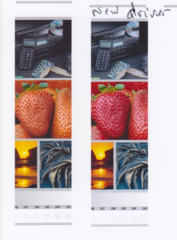

I should have started with reinstalling the pilot....
It works as you can see on the scan below (on the left,  before reinstalling, on the right, with reinstalling latest driver) 
Thanks for your help.
JM

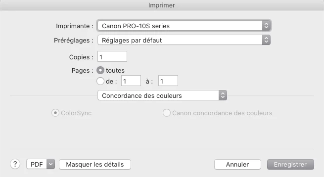

actually there is no possibility to change the option. Colorsync is checked, but both options are greyed.
I always wondered if it was normal as it differs from within Lightroom and from standard Mac OS dialog.
screenshot from Printer Setting from Lightroom (in french)

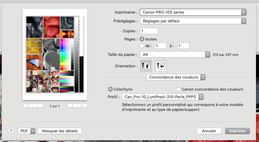

while from standard print dialog (launch from Preview), I have more options:
