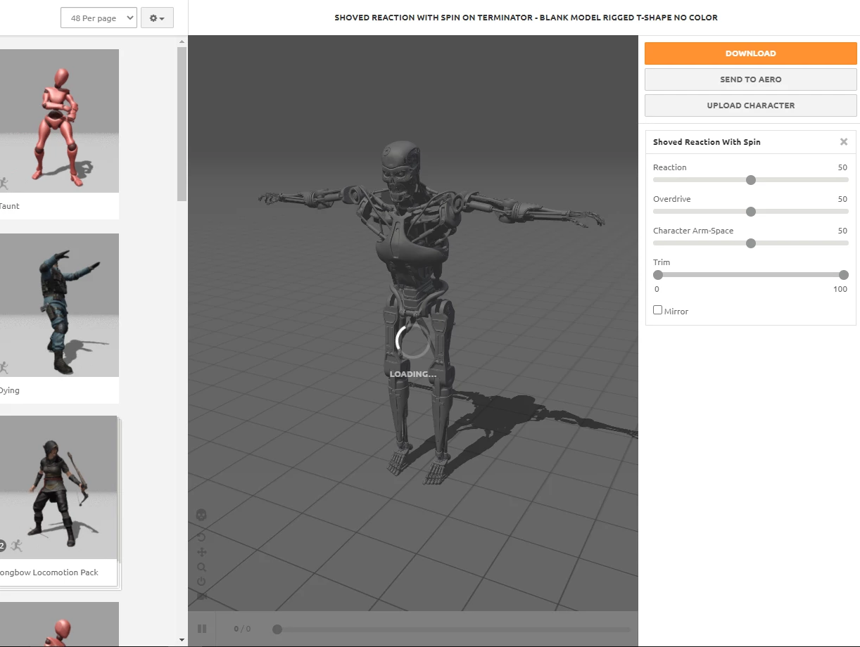

I have used Mixamo quite often, and have even uploaded a Character (Ironman), rigged it, and applied some of the preset animations for my video.
However, with this new model I have (Terminator), it uploads okay, it gets rigged okay (I successfully downloaded a rigged version), but when I try to apply a preset animation, it gets stuck in a continuous loading.
Has anyone experienced this, and have any advice or idea on what I might be doing wrong?  Any help is much appreciated!  Attached is the .fbx file I used.
Bernie

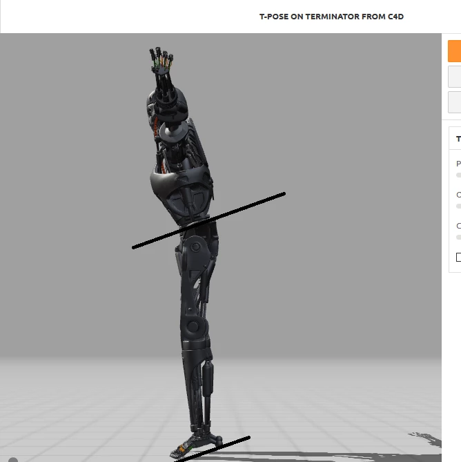

Hi Bernie,
the model is too complex for Mixamo to autorig into standard human animation
I would adjust the feet first so he sits back on his heel... that should do it but the hips could also tilt back a little mate

Hi Bernie,
October 16, 2020
Ahh okay, let me try that! I'll let you know if that works.
October 16, 2020
@Ussnorway7605025 IT WORKED!!!!  Genius, thank you so much for taking the time.
