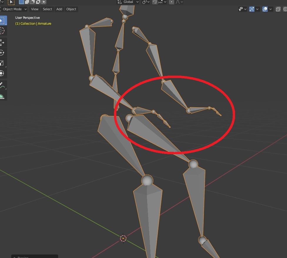

The skeleton has 1 finger on each hand, although I want all fingers.
  • May 11, 2021
  • 3121 views

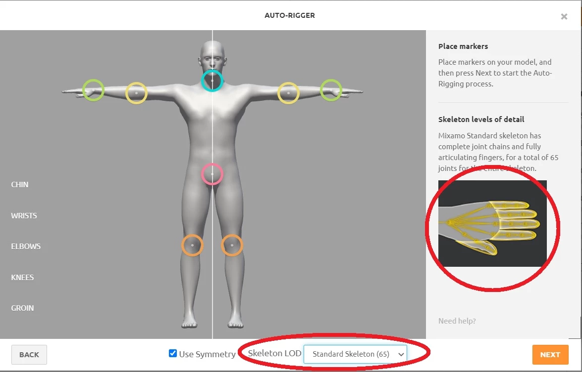

I upload a human obj model from Makehuman and set up a standard 65-joint skeleton. He should have all 5 fingers on each hand like in the picture. But in the end I only get 1 finger. Other configurations (3 chain Fingers, 2 chain Fingers) also do not work and set the same skeleton with 1 finger instead of 3 and 2.
Why is a standard skeleton with all fingers actually a skeleton with 1 finger? Is it like this for everyone, or just for me?
Correct answer defaultocgvoetpvdpe
I found the reason! The fingers in the T-pose were too close together. It was necessary to rotate the thumb and little finger a few degrees, then all fingers can have bones. It is strange that such a feature of the autorig system is not mentioned in FAQ.

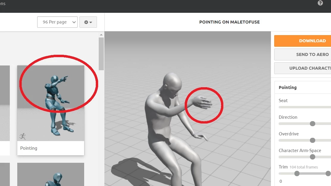

May 11, 2021
what format are you downloading as?
May 11, 2021
FBX binary or FBX for Unity
