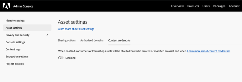

I also get the same message as others when trying to use the Nano Banana model in Photoshop. Since I am also an administrator at my institution, I have access to the administration console. Unfortunately, the Non-Adobe generative AI models tab is not visible at all in the Asset settings section. Instead, Content credentials is displayed. I am attaching a screenshot below.

I'm the same as you. I'm an admin. and I don't see any tab in the Access settings that says Non-Adobe generated AI models

I work for a school district and I am the Admin and User for the Admin Console. I can confirm that there is no option to enable or disable use of partner Ai features. I followed the directions of it's location in the console and it is not there.

While using gemini nano banana AI in Photoshop Beta it shows admin error , but they told to check admin console - asset settings - turn non adobe generative AI but there is no setting called Asset settings in admin console When Our admin team checked in the console  .Ours is Adobe enterprise Subscription, Kindly help us in resolving this issue ASAP. Below attached some Image reference of the error.

Same here. No options in the Admin Console. Only Sharing options and Authorized Domains. (Italy). Not released yet in EU?
