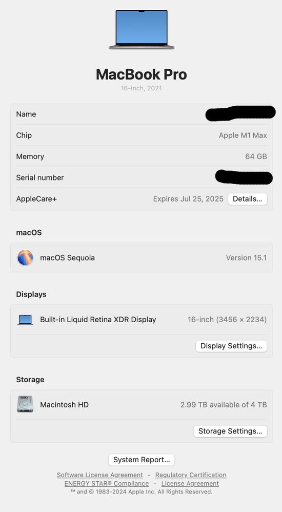

Nov 21, 2024 Nov 21, 2024
I been testing on the Mac side in the latest Photoshop Beta 26.2 m.2866 with scanned slides, negatives, camera raw files
and other misc images with color casts and still don't get any difference when using Image>Auto Color in either the Photoshop Beta or the stable release of Photoshop such as 2025 (ps version 26.1) and other stable release versions.
I'm testing on an Intel Mac running macOS Sonoma 14.7.1
Are the results your seeing on an Intel or Apple Silicon Mac?
Community Beginner ,
I am working on a MacBook Pro with an M1 Apple Silcon based CPU. All 15 other other designers in my department have the same problem - that they noted after I pointed it out to them - and the same optimal results in their full working PS 2025 (26.0.0). And it has been that way for as many relMAC_INFO.jpgeases as I can remember.
