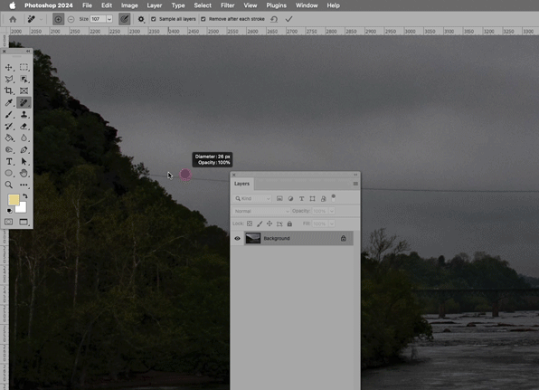

Could you please post screenshots taken with the pertinent Panels (Toolbar, Layers, Options Bar, …) visible?
The Remove Tool seems to work fine here.

Sure, here you go. If you really want me to post another one, I can, but the gist of it is that once I try selecting the subject, it gives me a message indicating that there is no prominent subject to be selected. Which, in turn, as I said above, means that the Generate button never appears so I can't follow the instructions in the link I posted. Hope this at least helps explain.
PS. If you look closely the brush tool is used to brush over the powerline, hence the thicker black line.

Please just try the Remove Tool set to »Remove after each Stroke«.

So as you can see from the new screenshot, I WAS able to get this done with a pretty good result. I will say, though, that the "Remove Tool" was not easy to find. I actually even asked ChatGPT about it, and it responded "As of my last update, there isn't a tool or feature in Photoshop referred to as the 'Remove Tool' with an option to 'Remove after each Stroke.' So I'm assuming that this is a fairly new addition. Furthmore, it wasn't one of the items shown in the menu on the side by default. I just stumbled up on it when right-clicking on the Spot Healing Brush Tool (yes, with the help of your screenshot, but I didn't know you had to right-click it). Again, I do NOT use Photoshop a lot.
So, the bottom line is that, yes, mission accomplished as far as the actual photo goes. But I'd still love to eventually figure out how to do this the AI way.
