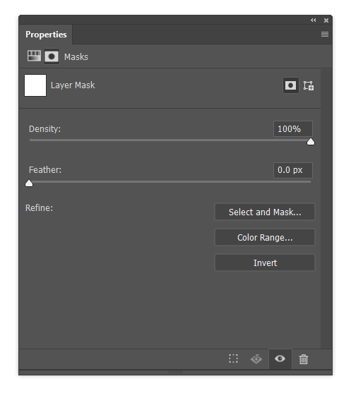

Just got a new position, setting up new imac and photoshop and getting my workspace how i like it, and find the Hue/Saturation adjustment layer just...doesnt work. It has nothing to do with color values, just "Density" and "Feather". All other adjustment layers have their properties display correctly. I can use H/S as a destructive edit, but thats it.
I havent even gone into Preferences yet, so its not a "reset preferences" issue.
Sep 06, 2025 Sep 06, 2025
Can you show us a screen shot of your workspace with layers and properties panels?
So this is a new system, and Photoshop has been installed for the very first time?
Is this the release version of Photoshop?  Beta now has a new Color & Vibrance adjustment layer.
It sounds like you are able to select the Hue/Sat adjustment layer, but it is not showing what you expect in the Properties panel.
Anything you can tell or show us to clarify would help.
Just realised whaty is going on.
You have the mask selected
