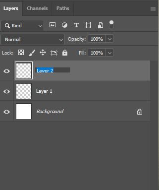

Since I am currently not able to make a video, let me outline the exact steps here with screenhots:
- At first, I create 2 layers, Layer 1 and Layer 2
- My goal ist to copy the name "Layer 1" and rename Layer 2 to "Layer 1"
- I double-klick the Name of Layer 1
- The Layer 1 name is marked
- I press "Ctrl+C" to copy the Layer 1 name
- Then I double-klick the name of Layer 2
- The Layer 2 name is marked
- I press "Ctrl+V" to paste the "Layer 1" name and overwrite the Layer 2 name
- Expected result: The Layer 2 is renamed "Layer 1"

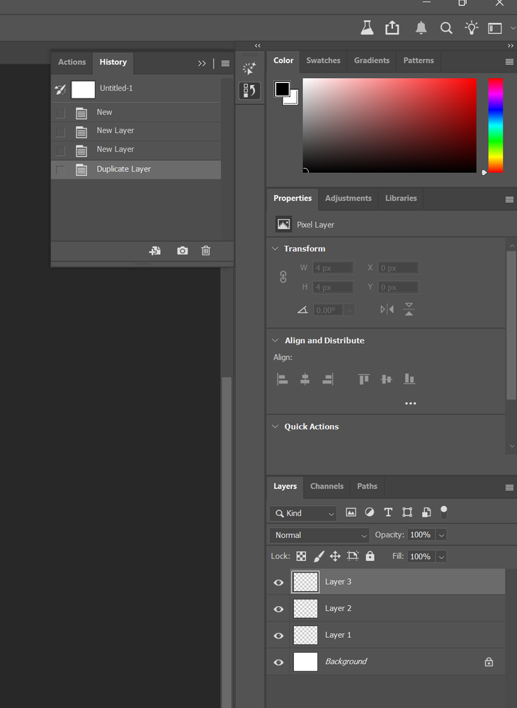

- Actual result: The whole Layer is copied and pasted as "Layer 3"

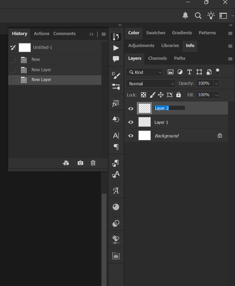

Jul 29, 2025 Jul 29, 2025
@3Dvice I followed your steps exactly, and I still can't reproduce the issue, see screenshots and history
Do you get the same result by right-clicking and selecting copy and paste instead
I just downloaded the Beta version to test, and I can replicate the issue there, seems to be fine with the right click, copy and paste, Ctrl V seems to trigger it in the Beta version, none Beta version works fine for me
