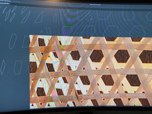

I have got a problem with the new Photoshop version (21.1.3), which I didn’t have in version 21.1.2. When opening a saturation or levels dialogue for a layer or a selection with Cmd + U / Cmd + L, the application freezes completely. Interestingly it doesn’t freeze officially, so when checking the Mac task manager Photoshop is listed as working and doing fine. But within the programme you can’t click on, stop or save anything, not even hide Photoshop. This error can be reproduced reliably, especially with complex pictures containing several layers. If the picture contains only a few layers (one to three) the controller in the open dialogue does respond, but only slowly and reluctantly. A possibly work-around seems to be to uncheck the box for „use graphic processor“ under preferences > performance. But that also disables important functions I use regularly.
I have now gone back to Photoshop version 21.1.2 and everything runs smoothly again.
I am using an iMac, 27 Zoll, 2019, RAM 40 GB, the graphics board is a Radeon Pro 575X 4 GB and the  Processor 3,1 GHz 6-Core Intel Core i5.  A colleague of mine with the same computer set-up but a slightly better graphics board has noted the same problem although he struggles a bit less with it due to the better performance of his graphics board.
I have already contacted the Adobe customer support but they couldn’t help me as this seems to be an inherent bug that needs to be solved on a programming level.
It would be great, if something could be done about this please!

@alexxi – Wacom, no. not for this demonstration. If everything would work i would use my wacom intuos pro s (PTH-451). But I had nothing installed that could cause problems with Photoshop, to be sure it's not a Plugin or any other failure. Puh, nevertheless i'm still happy that im not alone with this.
@charlotte – Yeah,yes this is the other weird behavior which is new in the last version. What we are discussing here is another bug that is also present in the previous versions. The workaround for your Problem is to hide the rulers or use hue/sat as an adjustment layer.
