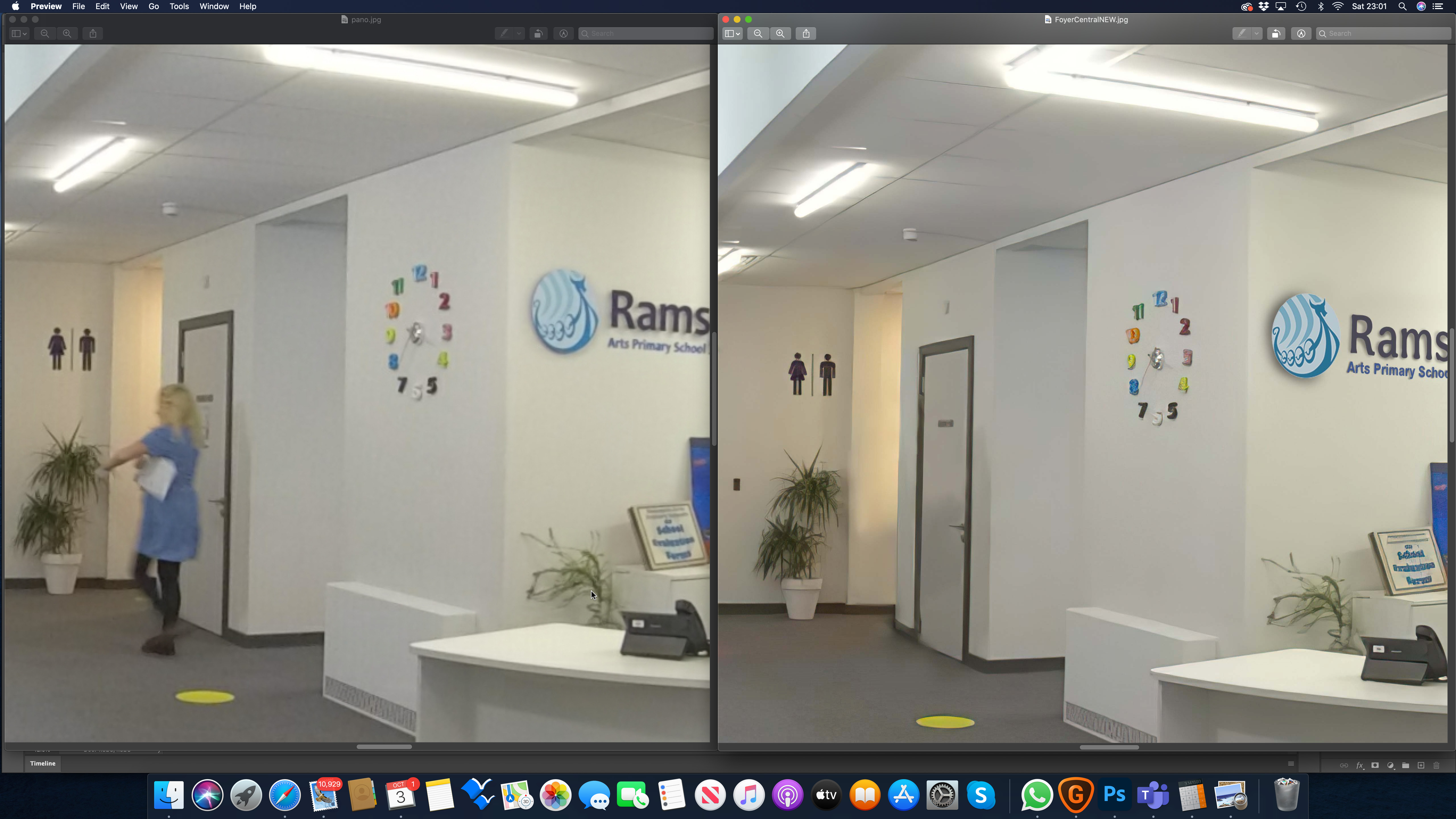

@zoltan_kerenyi Okay, I've found a not exactly perfect but an easy and workable solution to this but it does cost $100. However, I would say it's worth the investment. You can basically do your editing as per usual via photoshop and export the file. I experimented with a 10MB jpeg image shot on the Insta360 Pro2. After going through the standard Photoshop procedure the final exported file was 1.2MB. I put it into Topaz Gigapixel and even on the default settings it was amazing. I increased the file size x 4 and exported the finished image which was now 248MB!!!! I then repeated the Photoshop process and exported what is now a 4th gen version of the image. The final result was 12MB. But, and here's the crazy part, it was substantially better than the original image... and I mean SUBSTANTIALLY even after PS had reduced the quality from 248MB to 12MB. This is, in my opinion, far easier than any other workaround offered so far. I know it means buying a new piece of software for $100 but think how much time you've spent trying to get an answer from PS and work out what your hourly rate is and how many commercial jobs you could have done in that time and I think $100 is worth it. I'd seen it on Ben Claremont's YouTube channel and was sceptical at first but it really did work for me. It's not perfect but it's better than the original PS result. See the attached image which is an extreme zoom. The image on the left is the original file and the one on the right the 4th Gen PS file!
And here is another example where I've used the stamp tool to remove a woman from the background of a shot and used the warp tools and text to rebuild a logo on a wall:
