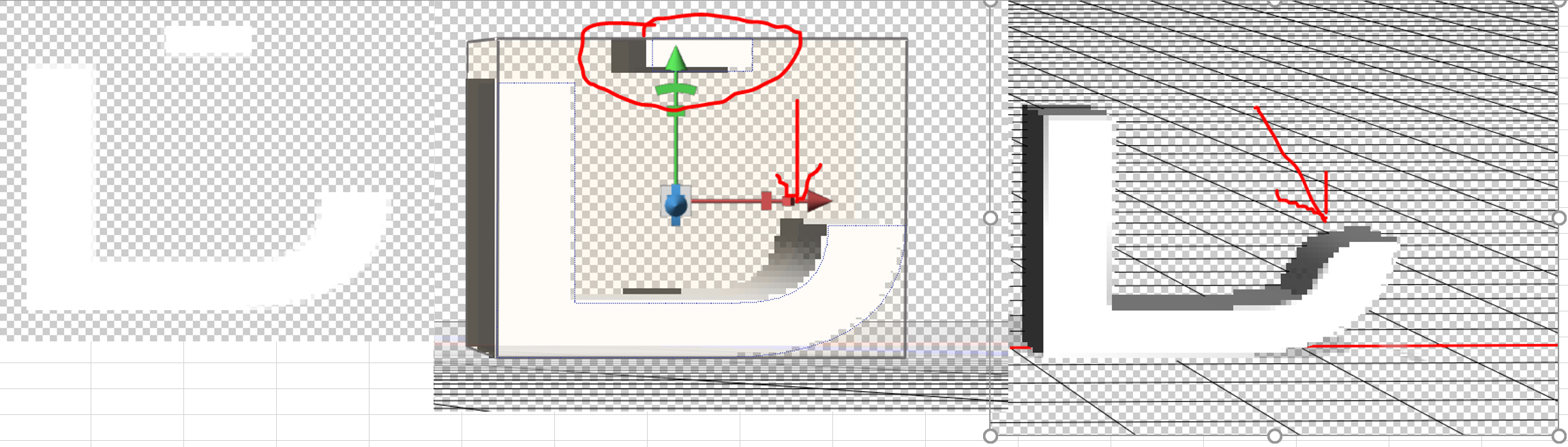

I keep having the issue of my objects looking perfectly fine and then when I go to "3D Extrusion" and pop out my design, it rounds edges and straight lines sometimes get rounded off and corners get rounded instead of being a hard edge. I'm not sure if there are settings I can change to make an EXACT extrusion of my piece rather than it auto tweaking edges and corners etc. I've went through all the settings I can imagine and about to lose hope with Photoshop 3D. PLEASE HELP!!!
In the attached picture, I show an example of what it's doing to a LOT of my items. Also you will notice that when I leave the little floating rectangle above the letter, it extrudes PERFECTLY how I want it. However I don't want the rectangle above the L so I erased it pre-extrusion and then it decides to round off the edge. Thanks for any help on this.L.PNG

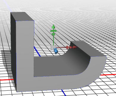

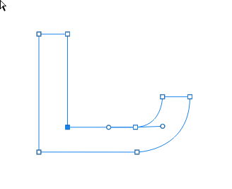

To try and replicate the issue, I traced your shape with the pen tool to create a path

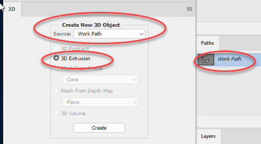

Then used 3D extrusion from Work Path
I don't see the issue you described :

Typically I take a logo or shape and cut out all around it or take a PNG image and just "3D Extrude" layer and it seems to be a gamble whether it will work right or if it  will round and re-shape some parts of it. I have never used the "work path" like you mentioned above so maybe that is my problem. Will come back after i try it.

Making a path often works best as you can keep the path nice and clean, which in turn leads to a clean extrusion.
