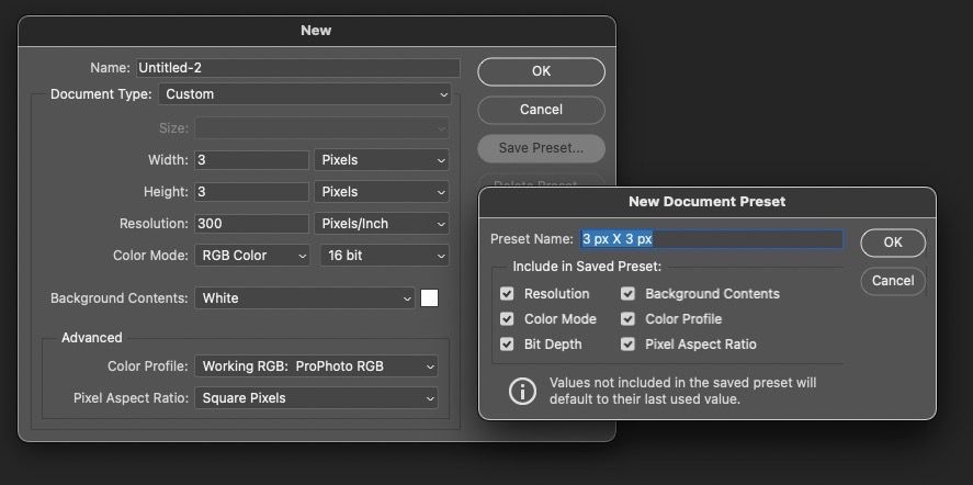

- Finally, is there a way to set the default setting for new projects in photoshop as 16 bit?  I can't find that option in preferences, and it always opens new files as 8-bit by default.

3. Yes, you can create new documents to be in high bit (what Photoshop calls 16-bit) but if you're working with scans or camera originals, it has to come from those in high bit.
You can make a "New document" preset seen below or once you make a document, the dialog should be sticking (next time it will remember all those settings).

  • Once you use the New dialog, its settings should stick. The option to choose color depth (I believe you can make an action too if you don't feel like going into New every time):
