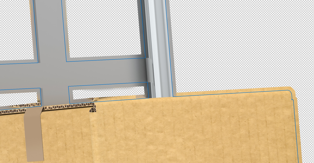

January 28, 2020
Stephan,
I appreciate the effort, but I'me talking photo vs. vector. I think I found a way. I made a copy of the layer, I took the outline and made a selection, expanded the selection, and then did a Content Aware Fill. It basically took all the color along the edges and "Grew" them. Seemed to work well for my purposes. See attached. The blue line indicated the original edge of the photo as well as the die-line. Very little touch-up after the initial process. Literally took moments, once I figured it out.
