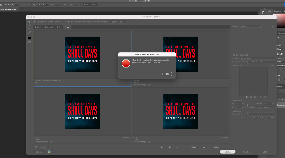

I have been experiencing this error for a while now. When trying to save for web it stops working and gives the warning "Save for web error" "Could not complete this operation. A writer permissions error has occured."
Everytme I tried the different solutions found online and they worked just fine but not this time. Everything was fine yesterday but today it just does not want to write this file.
I have tried the following:
1) reset preferences
2) update photoshop
3) Restart photoshop
4) Restart system
5) Give photoshop a complete write access to the disk
6) Checking that file and image sizes are the same
7) Trying different formats
I am on Photoshop 25.0, please help.

Does it happens only with this file?
Community Beginner ,
Oct 18, 2023 Oct 18, 2023
No this is with every file making the all Save for Web useless.
Oct 19, 2023 Oct 19, 2023
Thank you for the feedback but as described in my original post I have already tried all these methods with no success.
Update I also have Photoshop 2023 installed and the Save for web works just fine with that version. It is only with Photoshop 2024 that there seems to be a problem.

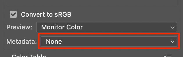

Hola! tenía el mismo error, y se solucionó deseactivando la "Metadata" -  tienen que estar en "None".Captura de pantalla 2024-09-19 a las 11.28.33.png
Espero te sirva!

Hi, I tried the "no metadata" suggestion.
But I still get the "Could not write the file".
