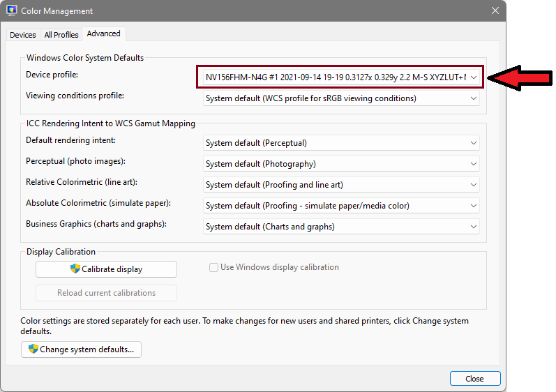

On the last page of discussion on the Microsoft forum Omelette14123123 provides a way how to force a device profile. It is not the most optimal (since the windows engine will control the color and many will lose the ability to manage the system color profiles through third-party software), but, perhaps, it can temporarily solve the problem.
At the moment, I'm installing the update again to check this way.
UPD: Yes, this seems to work. Checked it out.
