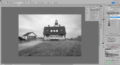

Oct 04, 2022 Oct 04, 2022
Having an active selection and adding a mask via Right Click > Add Filter Mask worked for me.
Having an active selection from the Channels Panel and applying it to an existing smart filter mask also worked for me.  Have I perhaps missed a step?
