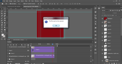

I'm facing this problem when i add audio, please help me out..

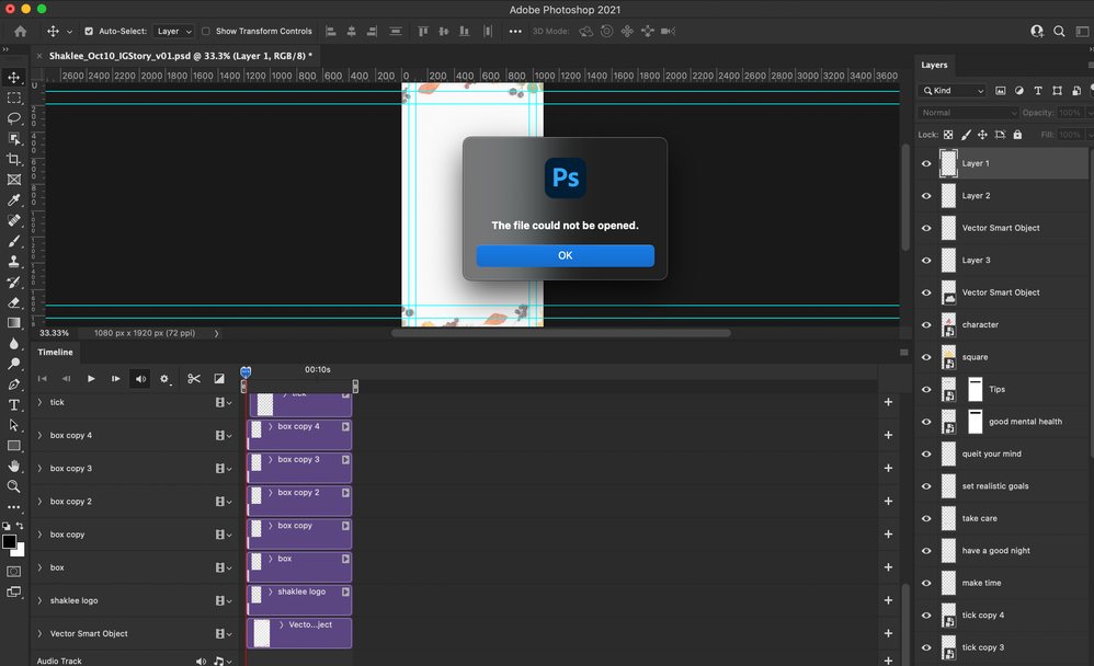

even changing to aac not working. Is this bug or how to add audio. need urgent.
latest ps with latest mac os

I have issue on photoshop, there is not way to read all my audio file. How i can solve this problem?
