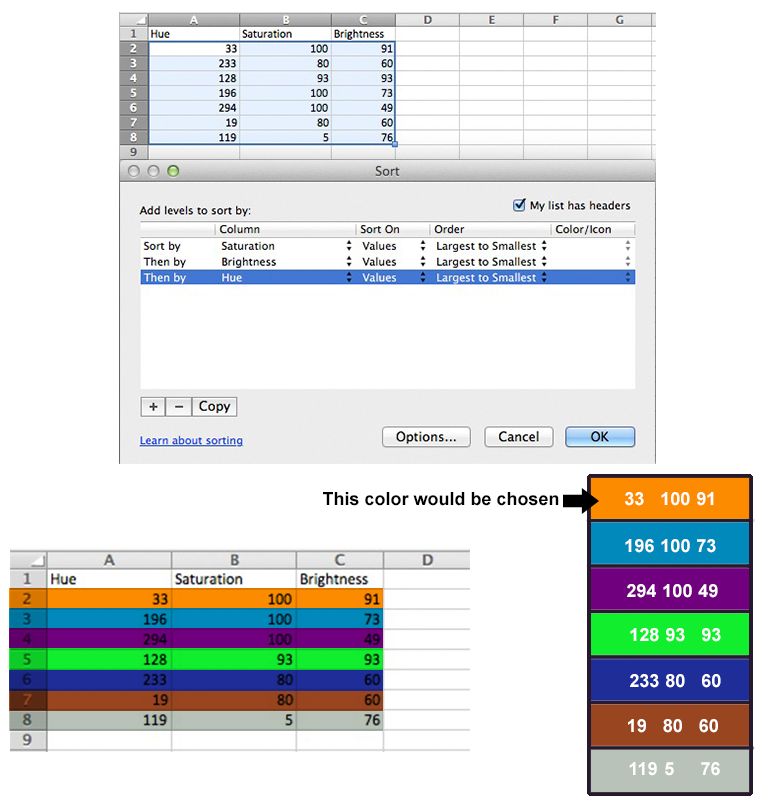

Thanks r-bin! That does what you said it would but what I need is not the average saturated color that prevails in the picture but instead the "most" saturated and if tied with others, the brightest, and then by hue if it came to it.
So if this were equated to a sort in excel, and the columns were Hue Saturation and Brightness (HSB) I would sort by S(aturation) and then B(rightness) followed by H(ue)
Do you think the script that you shared could be modified to do that? I do have the plugin installed. I have attached a visual of what I am trying to accomplish.
