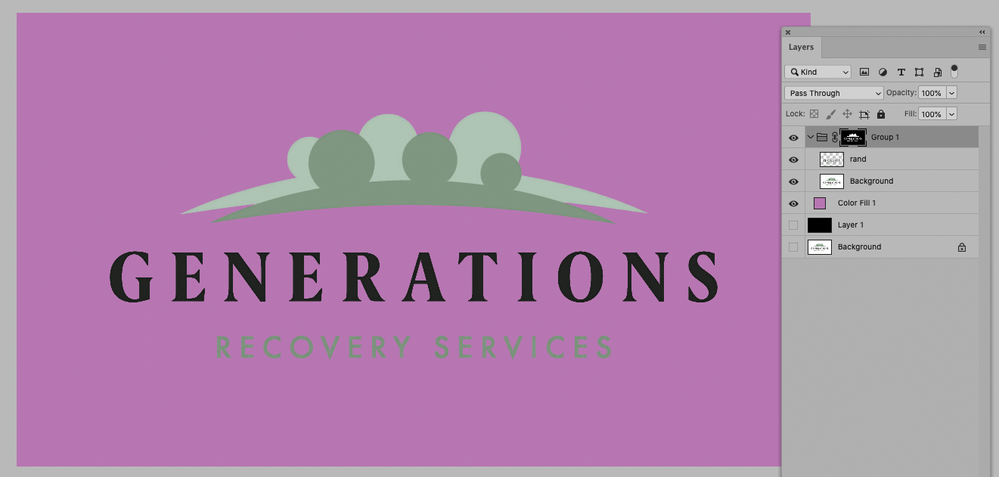

Here is a simple two click solution. Magic wand click on white. then Alt+Click add layer mask button in the layers palette.
Select what you want to keep add a layer mask using the selection.

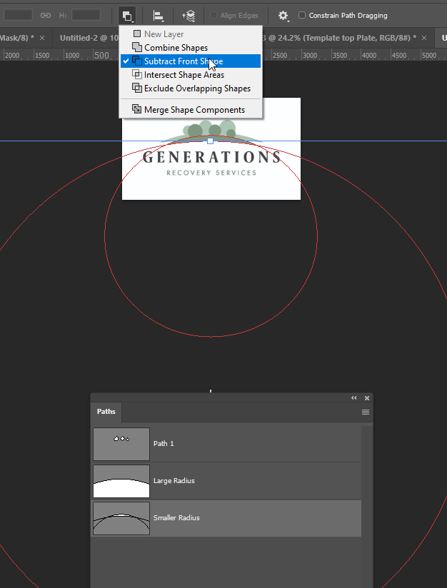

There is absolutely no question that you should rebuild the graphic and then add the text as type layers keeping the whole thing as a vector that will scale and print perfectly. Where I might question though, is in how to rebuild the graphic.  Rather than try to trace around the original with a single workpath (or one for the dark green and one for the lighter green), I would use the shape tools set to Path, and make each subsection separately and combine them.
Holding down the Shift key to force a perfect circle, which easy for the three smaller circles, but a bit trickier for the crescent.  The trick there is to get it close, then use Free Transform and Alt (opt) drag a corner handle to maintain the perfect circle.  You can see from my screen shot the bottom of the crescent is not round, as it matches most of the circumference but has a dip in the centre.
I always have to think about this.  We need to remove the large radius from the smaller radius to leave the cresent, so we select and copy the large radius. (It's important to do this the right way round) Then select and paste onto the small radius, and choose Subtract Front Shape from Path Operations.

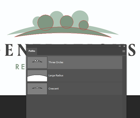

Then click on Merge Shape Components and we are left with the crescent
The last bit is super easy. Note: I have renamed the paths for the sake of clarity.
I selected and copied the cresent path (I'm just using Ctrl c to copy and Ctrl v to paste) and paste it onto the Three Circles path.
Make sure Combine Shapes is selected in Path Operations and click on Merge. and you have a graphic that even a OCD pedent would be happy with.

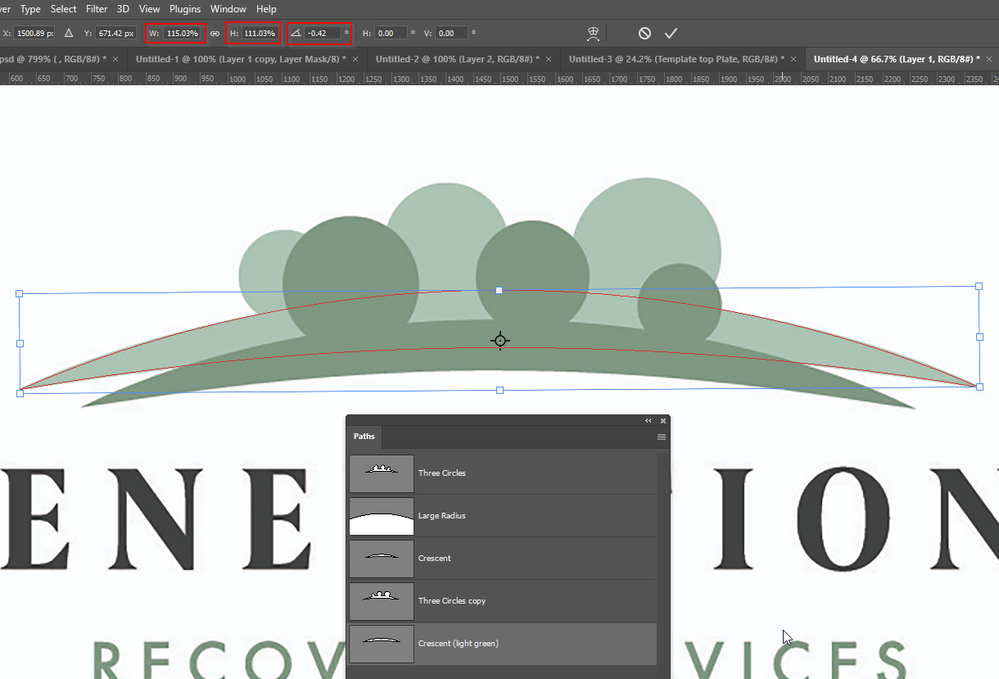

I was hoping that the light green graphic could be a simple case of flipping the dark green one and making it larger, but it didn't quite work out.
It will be easy to make it using the existing paths, although it would have been easier still if I'd used a copy of the three circles path.  I got a good match with the crescent using these settings, but note that the aspect ratio is not quite the same.
