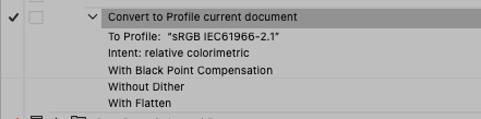

Dec 04, 2024 Dec 04, 2024
How do you verify that it "refuses to apply the sRGB color profile"?
Check here:
BTW - there is no such thing as "plain RGB". There is always some RGB color space.
Community Beginner ,
Dec 05, 2024 Dec 05, 2024
Thank you so much. The image you shared was quite helpful. I was utilizing File Info to check the status of the profile.  (I resolved the problem eventually by changing the Working RGB space in the color settings box.). My files all show a color space as "RGB" and a profile as "Adobe RGB" (or sRGB for the jpegs.) My color settings show Adobe RGB. Where does this color space become defined?
Next, I am the photoshop idiot of the month. (Hopefully my identity will stay reasonably confidential, so please do not mock me), but I completely forgot that I was doing color correction for my images on an imac screen that I had set, in system preferences, with a home-cooked calibrated setting. It is easier on my eyes for it to be warmer and I FORGOT to change it to the Adobe RGB option.  The images look good despite, but obviously cooler than I would have made them, quite a large error.  With this in mind, please can you advise, when editing, should I have my monitor set to Adobe RGB, since I will be working with this profile for printing? Next, the TIFF's that I created to send to my client (with LZW compression) shifted and became much cooler (skin tone) than my original PSD files.  However, the jpegs I created, with sRGB looked much better/closer to the PSD's.  Thank you for your expertise.
