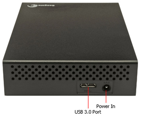

I am now up to eight external drives. Three WD My Books, and five Seagate Expansion.  I have had three WD My book drives fail over the years, and the Seagate drives perform better as well at 180MB/s continuous, as against 120MB/s for the WD drives.  The power blocks were getting a bit OTT, so I now power them via the computer's PSU — it has made things a lot tidier with two less power boards behind the computer desk.

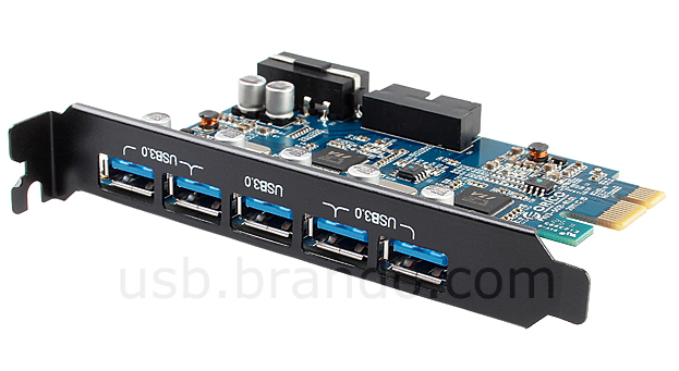

I chose a motherboard with lots of USB3 sockets for my 7900X build (MSI X299 fatal1ty gaming pro i9) but you can get USB3 headers if you have spare PCIe sockets.  You ,might need to check that you have the PCIe lanes available to make the most these.  With so many drives, it can become a real issue.

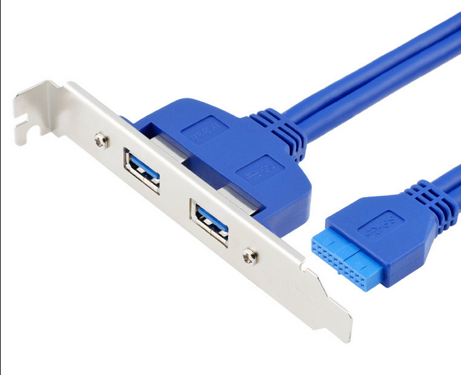

I also got a header to bring two internal USB3 sockets to the back pane.  This is on top of the two USB3 at the front of the case.  For the sake of a $10 header, it seems crazy not to make the most of all available connectivity.

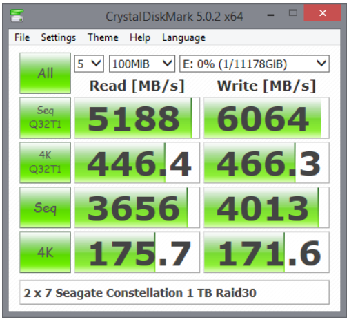

It's sad that Harm Millaard passed away, as he would surely have the ultimate solution using today's storage options.
Choosing storage

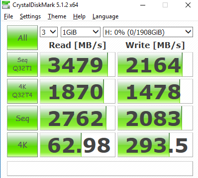

Even for 2015 Harm's nine SSD raid array had very tidy performance
Note that Harm and the PremPro Hardware guys always used proper raid controllers, that being the Areca ARC-1882ix-24 controller for Harm's 9 SSD array.   You'd pay $600 for a modern version of a card like that.
This is for the 2Tb version of the Samsung 960 PRO MVMe drive.  That's a single drive not so far behind Harm's nine SSD raid array performance.  The times they are a changing, but no one os going to shell out $12K for 48Tb of NVMe storage, and nor would they need to.  A single 2Tb drive would keep you in project space for quite a while, unless you are Peter Jackson using two dozen RED Epic or Weapon 8K cameras.  Then bump your old projects to slower external storage.
