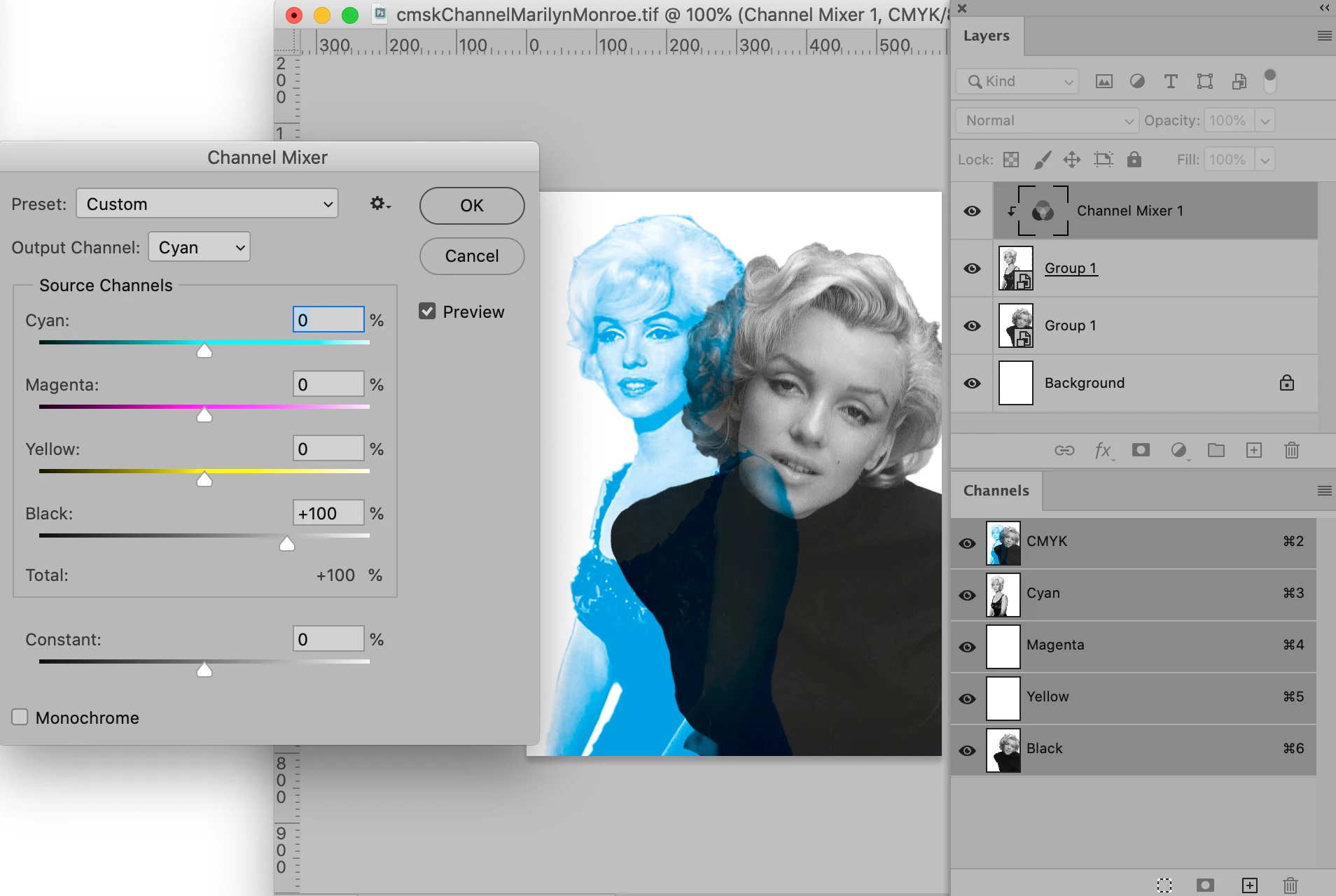

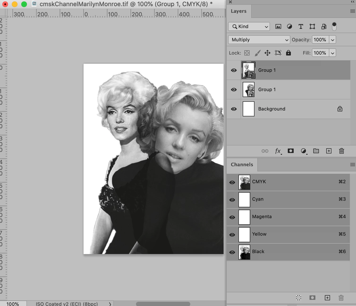

Could you please post a screenshot with the pertinent Panels (Toolbar, Layers, Channels, Options Bar, …) visible?
Indesign would only process the four CMYK-Channels unless the additional Channel is a Spot Channel.
One could also use Layers with only black content
and Channel Mixer Adjustment Layers to transfer it to another CMYK-Channel.
